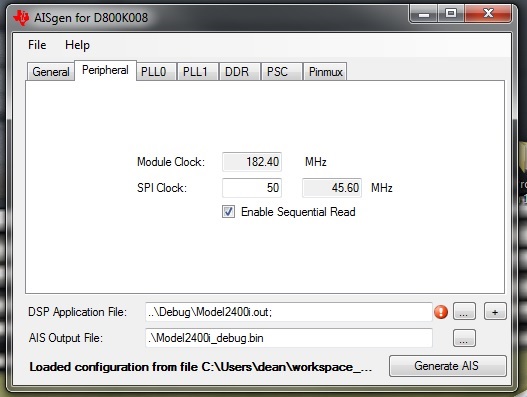

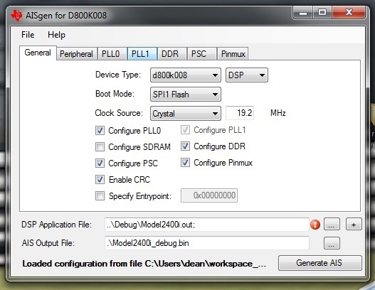

    The SPI FLASH is a different density, but from the same vendor.  The SPI boot speed is the same as the other projects.  I've attached snapshots of the AISGEN configuration information.
    We haven't tried a RESET on the emulator, as that screws up our environment.  However, I can tell you the Debug GEL file shows SPI1 as the boot method when we emulate normally.  In addition the scope images clearly show the TI ROM bootloader accessing the SPI FLASH after the RESET, so the boot pin have to be correct.  We are aware of the silicon errata that requires stronger pull up / pull down resistors on the boot pins.  We are using 1k resistors.

  • Dean
    The SPI clock speed seems to be much higher than what we typically support.
    There is a note in the boot loader application note(Pg 13)
    For SPI and I2C master modes, you can enter a desired speed. Depending on the PLL settings and
    granularity in peripheral clock division, AISgen calculates the actual speed nearest to the desired speed
    and shows it in an adjacent box. Recent I2C devices support speeds up to 400 kHz, and SPI devices
    support speeds up to 33 MHz
    Can you test with lower than 30 MHz SPI clock frequency.

    We slowed the SPI clock in the AISGEN to 30.4MHz.  No luck.  I'm not sure why the ROM bootloader has a 33MHz limit, while the C6748 datasheet allows 50MHz.  Doesn't make a lot of sense.  By the way, if the ROM bootloader 33MHz limit is real, then the AISGEN program shouldn't allow you to enter a value greater than that.  Help us out where you can :)

  • Antony,
    Yes we did compare the Power up / Power down / Reset waveforms between previous working products and our new one.  No difference.
    The good news, is we think we found the problem.  All our previous products used a SPI FLASH that was less than 16MB, and thus only required a 24bit address.  The C6748 bootloader document clearly says it requires a SPI FLASH that supports 24bit address.
    Our new product has 32MB of SPI FLASH, and the way we access all that FLASH space is to turn ON a bit inside the SPI flash so it requires 32bits addresses for reads and writes.  We had to write our own boot the bootloader application, so that the C6748 ROM only boots a small project, and then we continue booting after we've switched to 32bit addressing.  We completely forgot about this 24bit vs 32bit difference.  So what was happening, was the brown out was low enough to trip our DSP RESET, but now low enough to drop our 3.3V rail.  Because the 3.3V rail never dropped, the SPI FLASH never got a HW RESET, and thus was stuck in 32bit address mode when the C6748 ROM boot code attempted to access it using only 24bit addressing.  If the brown out was low enough (or power was completely removed), then the SPI FLASH would get its HW RESET, default back to 24bit addressing, and everything worked correctly.
    Thanks for the help.
  • Mukul,
    Can you please clarify the C6748 ROM requirement for SPI FLASH that it really has a 33MHz limitation.  We have always used 50MHz with no problems, and the C6748 datasheet clearly says it supports 50MHz.  If the 33MHz limitation is real, please explain why and update AISGEN so that values greater than 33MHz are invalid.
    Thanks, Dean
  • Hi Dean
    On further investigation on the comment on the boot loader application note, the 33 MHz is listed because this is what we had tested boot with few years back when the devices were announced. The bootloader author just wanted to capture the max/typical tested frequency.
    I did have another customer issue at ~ 50 MHz boot speed, but going through older threads, that ended up being a customer board problem.
    There are limitations with SPI slave boot mode speeds, but these are comprehended in the datasheet timings and companion boot wikis.
    50 MHz should work for boot too, as indicated in the datasheet timings for the device.So no change needed in your firmware for previously designed boards. I apologize for the confusion.
    In general, we do not burden the AISGEN GUI to generate error messages for out of bound frequencies, expectation is that the end user will look through the datasheet max limits and use the tools accordingly. We do provide additional ease-of-use tools in terms of the PLL calculator (which has been upgraded) to allow easier visualization and debug-ability.
