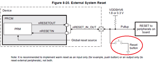

May I assert nRESETIN_OUT from external reset IC? (AM335x)
Guru 10570 points

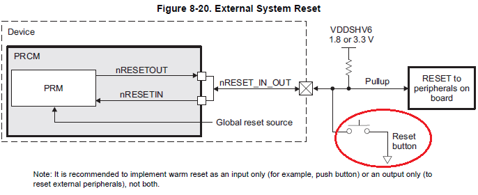

It seems that the TRM recommends push button as nRESETIN_OUT source. (spruh73h: P538)
