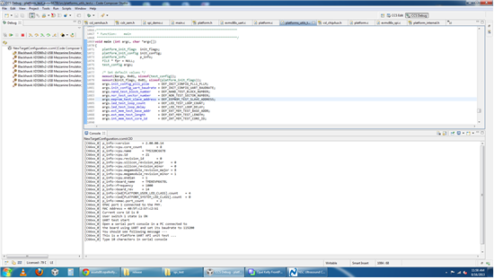

  • Chandu,
    I tried your test code (with Osal_platformSpiCsEnter and Osal_platformSpiCsExit in the same source file) on C6678 EVM and could see the Core keeps printing out 1/2/3/4 in while loop. I do not see it is stuck in CSL_semAcquireDirect  function and the Semaphore register shows 0x1 in the memory view.
    May I ask which platform your are working with and are you using the C6678 platform and CSL libraries please?
    thank you for your reply.
    Yes, I am using platform and CSL libraries of version pdk_C6678_1_1_2_5.

    thanks for your reply.
    C:\ti\pdk_C6678_1_1_2_6\packages\ti\platform\evmc6678l\platform_test , this  project I tested in my board. this is what I got in console.
     please let me know if any problem is exists.

  • It looks like you are in the middle of UART testing, which requires UART connection from EVM to PC and input in the serial window on PC as mentioned in the CCS console.
    UART test is before NOR test.  If you do not need to test UART, you could skip it (recompile platform test project) and proceed the others which do not require input I think.

    [C66xx_0] MAC Address = 40:5f:c2:b7:c2:b1
    [C66xx_0]
    [C66xx_0] NAND Device:
    [C66xx_0] p_device->device_id = 54
    [C66xx_0] p_device->manufacturer_id = 32
    [C66xx_0] p_device->width = 8
    [C66xx_0] p_device->block_count = 4096
    [C66xx_0] p_device->page_count = 32
    [C66xx_0] p_device->page_size = 512
    [C66xx_0] p_device->spare_size = 16
    [C66xx_0] p_device->column = 512
    [C66xx_0] p_device->handle = 8246
    [C66xx_0] p_device->flags = 0
    [C66xx_0] p_device->bboffset = 5
    [C66xx_0] Bad Block Table (only bad block numbers shown):
    [C66xx_0]
    [C66xx_0] NOR Device:
    [C66xx_0] p_device->device_id = 47896
    [C66xx_0] p_device->block_count = 256
    [C66xx_0] p_device->page_count = 256
    [C66xx_0] p_device->page_size = 256
    [C66xx_0] p_device->spare_size = 0
    [C66xx_0] p_device->handle = 47896
    [C66xx_0] p_device->bboffset = 0
    [C66xx_0]
    [C66xx_0] EEPROM Device (@ 0x50):
    [C66xx_0] p_device->device_id = 80
    [C66xx_0] p_device->manufacturer_id = 1
    [C66xx_0] p_device->block_count = 1
    [C66xx_0] p_device->page_count = 1
    [C66xx_0] p_device->page_size = 65536
    [C66xx_0] p_device->handle = 80
    [C66xx_0]
    [C66xx_0] EEPROM Device (@ 0x51):
    [C66xx_0] p_device->device_id = 81
    [C66xx_0] p_device->handle = 81
    [C66xx_0] Current core id is 0
    [C66xx_0] User switch 1 state is ON
    [C66xx_0] EEPROM test start
    [C66xx_0] test_eeprom: passed
    [C66xx_0] EEPROM test complete
    [C66xx_0] NAND test start
    [C66xx_0] test_nand: passed
    [C66xx_0] NAND test complete
    [C66xx_0] NOR test start
    [C66xx_0] test_nor: passed
    [C66xx_0] NOR test complete
    [C66xx_0] LED test start
    [C66xx_0] LED 0 ON
    [C66xx_0] LED 0 OFF
    [C66xx_0] LED 0 ON
    [C66xx_0] LED 1 ON
    [C66xx_0] LED 1 OFF
    [C66xx_0] LED 1 ON
    [C66xx_0] LED 2 ON
    [C66xx_0] LED 2 OFF
    [C66xx_0] LED 2 ON
    [C66xx_0] LED 3 ON
    [C66xx_0] LED 3 OFF
    [C66xx_0] LED 3 ON
    [C66xx_0] LED test complete
    [C66xx_0] Internal memory test start
    [C66xx_0] Internal memory test (for core 2) passed
    [C66xx_0] Internal memory test complete
    [C66xx_0] External memory test start
    [C66xx_0] External memory test passed
    [C66xx_0] External memory test complete
    [C66xx_0] Test completed
    and my source code for SPI is mentioned in previous posts. So please help me sir.
    thank you sir.
    regards,
    chandu.
