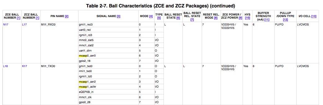

Is it  possible to get hold of this data in a text-format (or excel / xls) found in the AM335x datasheets?
Ball-number and pin-names are In the .bsdl text-file, but I'd also like the additinal signal-names incl. their modes and type's shown in the table below:
I had a peak in the Pin_Mux_Utility.msi (not on PC though) but couldn't find the traces of this data in there.
please advice.
