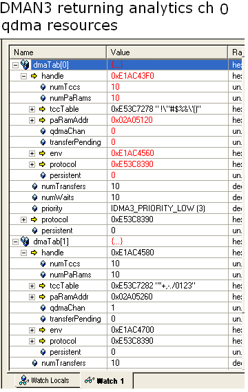

    With above configuration, The first analytics channel creation itself fails. the VISA_create returns NULL pointer. Only thing I knew from debugging, it calls "dmaGetChannels" interface implemented by analytics to inquire its dma requirement and fails. Normally, it calls "dmaInit" with allocated dma resources and VISA_create returns valid analytics handle.
    Just don't understand, the DMAN3 can't satisfy two qdma channels request with above configuration.
    Any idea what's going on here?

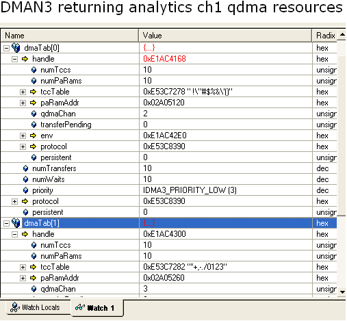

    When I set "tccAllocationMaskH = 0xffffffff;", I see the DMAN3 returning the qdma resources to analytics shown in attached snapshots:
  • The reason tccAllocationMaskH = 0x0000FFFF fails is that (from the above snapshot it looks like) the channel requirements for dmaTab[0] are 10 Tccs and then dmaTab[1] is another 10 Tccs.
    Allocation mask is set to make only 16 TCCs available for DMAN3. For the two channels, depending on which scratch groups they are, you would need anywhere from 20 to 40 Tccs. the tccAllocationMask has to be configured to make atleast as many available.
