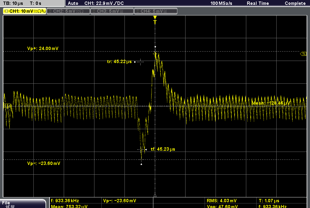

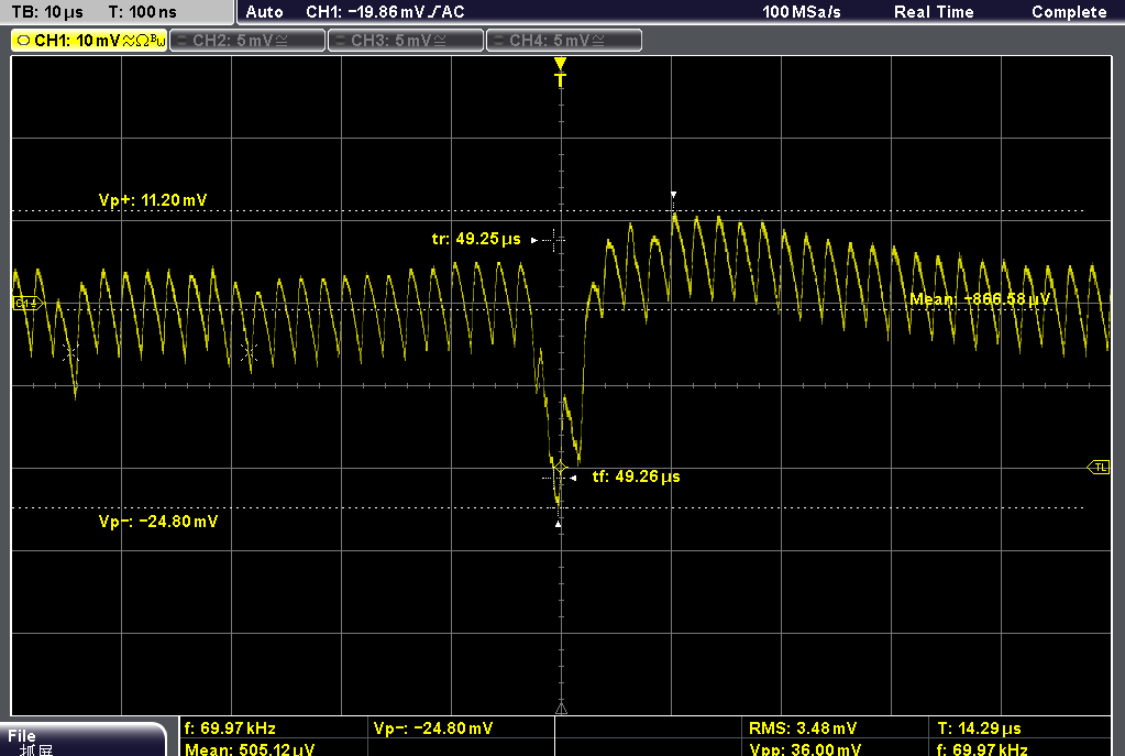

    I checked my design caregfully! and I recover the init capcitors and resistors as noted in the PMP7256 BOM(http://www.ti.com/tool/pmp7256).The only difference is that i replace the LM10010 with the LM10011,and set the initial voltage at 1.1V.and i check the ripple waves with the chipscope.the setting is :20MHz bandwidth, ,AC coupling with 50ohm resistor. i obsrved that there are voltage sinks when the DSPs are runing programs but it is very normal when they are not  .  the wave form is belowing:
    Image 1: the waveform with the 500KHz switch frequency with running programs.
    Image 2: the waveform with the 1MHz switch frequency with running programs.

    I do not know whether the CVDD noise is the source of the instability.  However, since you provide measurements, I will comment on this captures.  The full power supply tolerance is +/-5%.  You need to be certain that all voltage errors and noise components when measured at the load do not exceed this total.  The pictures above indicate this may be marginal in your design.  You are showing a capture with 50mv variation and this is half of the tolerance wiindow.
    You need to account for worst-case transients.  Proper bulk capacitance is needed to manage the overshoot and undershoot at worst-case transient step.  You need to use the calculators available with the TPS56221 to choose the proper supply bulk capacitors with proper ESR.  The maximum current step size is found using the Power Estimation spreadsheet for the C6678.
    The measurement was made with a 20MHz filter in the scope.  Why did you do this?  You need to be concerned with noise up to 200MHz.  All noise below this frequency must be managed by the decoupling network.  You need to measure all of the relevent noise.
    The PMP7256 design report discusses the summing of the tolerance error terms.  Please perform similar calculations and make sure that your worst-case design results in error at the BGA balls less than +/-5%.
