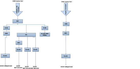

We have made custom board having DM8168 (NETRA) Soc. We are using DVR-RDK3.50.
We are facing some issue with fan control while we load DSP firmware from A8.
We have developed our own usecase (see attached usecase) by taking mcfw demos as a reference.
In this usecase we are not making use of DSP core. So we skip loading DSP firmware before running our application which solves our fan issue.
But when I am trying to run my application, It stuck at some point. See attached application log for reference.

 [host]  83, *pte=000000004: IPC_BITS_IN  , *ppte=00000000 : Create Done !

Do we need to make some changes in application if we skip loading DSP firmware ?
Let me know if you want more information regarding this issue.
