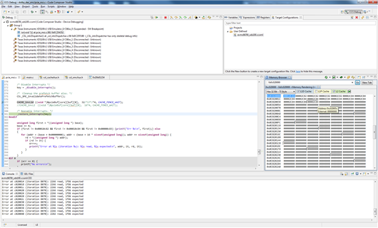

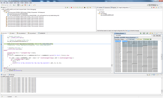

  • The code used to invalidate is:
          unsigned int key;
          /* Disable Interrupts */
          key = _disable_interrupts();
          /*  Cleanup the prefetch buffer also. */
          CSL_XMC_invalidatePrefetchBuffer();
          CACHE_invL1d ((void *)&pcieBuf[core][buf][0],  17*4, CACHE_FENCE_WAIT);
          //CACHE_invL2  ((void *)&pcieBuf[core][buf][0],  16*4, CACHE_FENCE_WAIT);
          /* Reenable Interrupts. */
          _restore_interrupts(key);
    It was copied from the PCIe sample application in the PDK_C6678 directory.
    pcieBuf is defined as follows:
       extern unsigned char pcieBuf[8][2][0x20000];
    This is before the call to CACHE_invL1d():
    This is after the call to CACHE_invL1d():
    Please note that the device writes constant data to the buffer, triggers a PCIe MSI. The device then increments the data value by 1, and fills the buffer with this new value. This continues while the C6678 is at a breakpoint.
  • Was there a read error after this?  It would appear that the cache invalidate worked, the fact that there is no tag ram setting it as cached causes the emulation to view that as White (instead of blue since that was in L1D cache at that time.)
    It looks like you have MSMC as an L2 so you don't need to do the L2 invalidate (if, MSMC was setup as an L3 which can be done you would have need to invalidate it as well.)
    It does look like you've gotten the newest data from PCIe write picked up on the previous execution.  Are you certain everything had been read out prior to the next PCI transfer.  Where you see the 0x2282 that's the first location of a new cache line 0x0C020040 if that happened to have been evicted before the reading, and the PCI had already updated (which it looks like the next set of data) then this would be what was cached in and it would make since given that the value is what you expect the PCIe to write the next time, correct?
