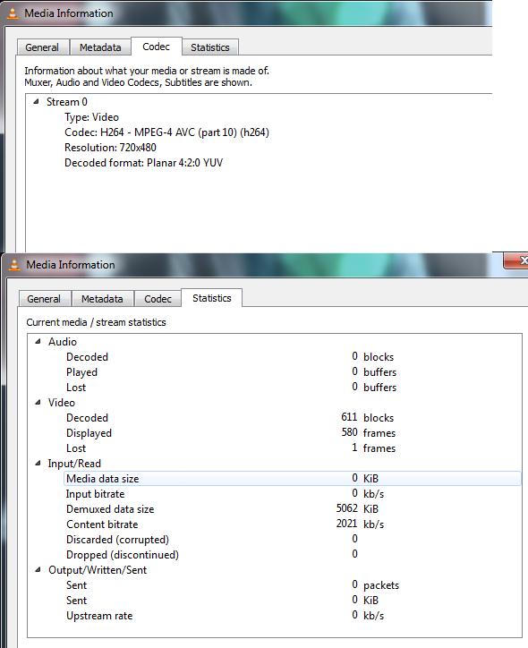

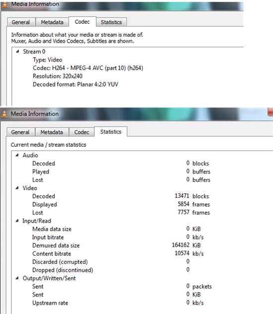

    Thanks for your response, I still sink in that issues. And now I have another one. I really need your quick advice in this case. I modified the third stream from using MJPEG to H254 with resolution is 320x240. I did it by just modify the use case to add 1 more scaler and change everything which relate to third stream to similar config as second stream and system are now running. The problem is the third stream was really not smooth and strong shrinking. I think I make some thing wrong in configuration during modification. From VLC media information I have the report to second and third stream as below:
    THIRD STREAM
    SECOND STREAM
    From above information, I guess the shrink problem which happen in third stream may come from packet lost, large DEmuxed data size and  content bitrate.
    Can you help to figure out the way to make the Demuxed data size and Content bitrate of third stream have similar value as second stream? I am sorry if this is a stupid question but I have not much experience in this.
