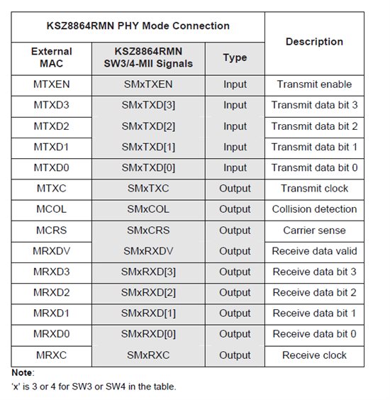

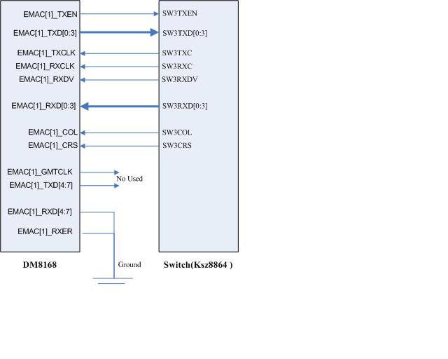

DM816x can support 2 GMII Ethernet Port.
I would like to know whether I can connect  EMAC1 of DM816x to  MAC port of Ethernet  Switch directly?  As the below, If yes, could you please let me know how it can
be done? According to Switch datasheet, the connection seem that is right. How to make change to kernel driver to support it.

  • Hi Colin,
    I did not look at the datasheet of this chip but I think there are a couple of pins that configure this chip either in switch mode or PHY mode.
    What you need to do is to configure to PHY mode for it to work.
    pb
  • Hi, I am sure  the port that connected to DM8168 EMAC1 is in PHY mode.  The connection and configure of ksz8864 is right.
    I am not sure how to make EMAC driver change to support  it.
    And I confirm that this switch chip TXC,RXC output 25MHz clock.
    thanks.
