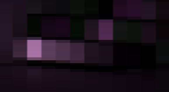

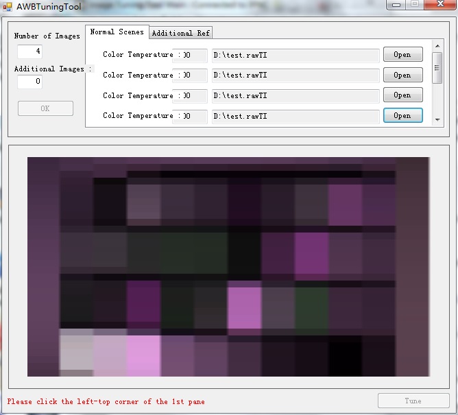

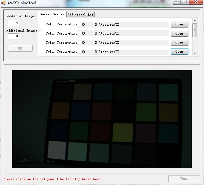

Hi everyone:
Recently,I use 10bit raw data CMOS sensor to connect with DM365. the bayer pattern is B,Gb,Gr,R,I modified the isifcfg and ipipecfg to the correct pattern,inputmsb to bit9,and the color of image output is correct. I use Image Tuning Tool to open captured raw data ,the color is also correct, but when I use AWB tuning to sample,the output color block isn't correct,I can't do awb.
The attchment is raw data.

  • We are in the process of migrating from DM365 to DM368, and understand that there are 'some issues' with AEW on the DM368.
    Although not conclusive, we have just done a simple [first off] test to evoke the AWB, and it doesn't appear to function [at all] - NB this is an 'out of the box' test only.
    If there are specific instructions, or documents, in relation to configuring the AEW functionality in the DM368, we would be very grateful for those links.
