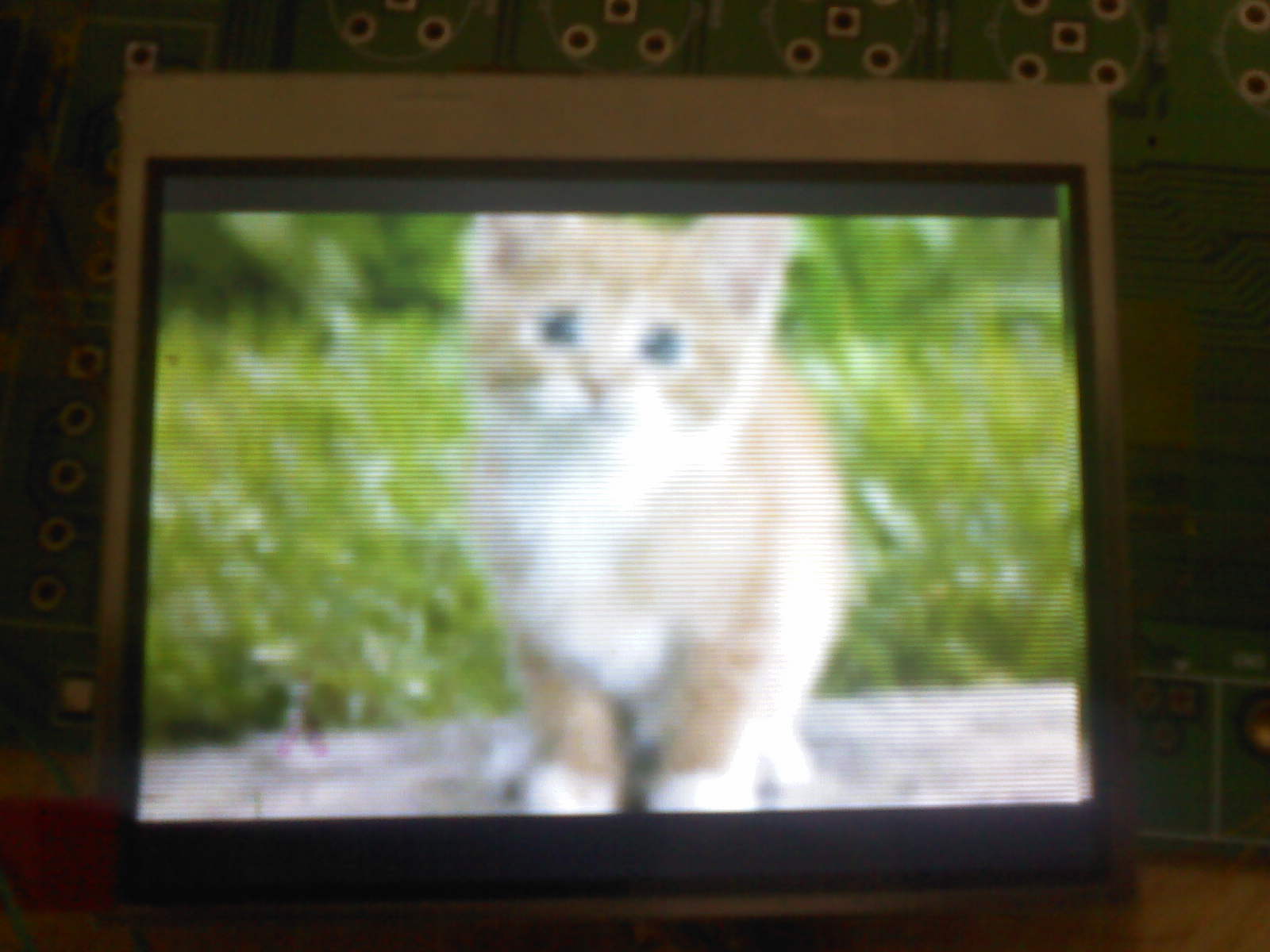

Hi Renjith
we are using new 320x240 RGB format lcd from u-boot we are able to draw the lines. But we are not able to display correct images on lcd it will display junk.
Any input on this.
Asif
Hi Renjith
we are able to display the bmp image on lcd display but it is displaying only 1/4 image.
Asif
Hello
We are able to develop and the load the driver for lcd module. we are able display the image on the lcd using driver but it is display only 1/4 image any idea on this. when we tryed to display one dot it is display 4 dot any idea on this. This is same from u-boot and driver level.
Please help us to fixed this issues.
Asif

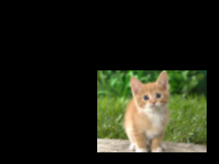

Hello
Enclosing Image original image and lcd image
This is original image 320 x 240
This image is on lcd
The problem is in original image 1/4 is cat image other place it is black color but i will take only if the image is at bottom right side. else it will not display any image on lcd. why ?
Asif
Hi Mike
Yes you can follow it will work. only I am facing one problem. it is displaying 1/4 image it is not display full image. At present I am busy with other project may be after 10 days. i will work on this display problem to display full image on lcd 320 x 240.
if you are able to fixed the issues to display full image please let me know.
Asif
Hi Mike
you are able to fixed this issues.
We are able to fixed this issues now the display is working. On both video and osd
Asif
