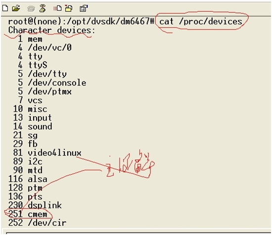

  • This is interesting, it certainly seems like CMEM was inserted properly by the loadmodules.sh script, however the demo is not able to locate the CMEM node. I see the module is there because of your lsmod command, but is there actually a /dev/cmem directory that was created upon insertion? If not I am curious if you are running the default kernel and configuration provided with the DVSDK, as the /dev/cmem node should be instantiated automatically upon insertion of the CMEM module. If you are running the default setup than there may be some problem elsewhere that we may want to dig into, if you are using a custom configuration than it sounds like your kernel and filesystem are not using udev, in which case you may have to run mknod yourself to instantiate the /dev/cmem node.

  • Thanks to Bernie, I solved this problem.
    As mentioned by Bernie, you probably use “mknod”.
    Pictures following show how i solve this problem:
    From this Screenshot above you can get the major-number of the device cmem is 251, and the minor-number 0(default)
    Then you can make the node, as show below
     If you done this work, you can insmod the cmemk.ko.
    Myenglish is not good, so please forgive me if my expression is not clear.
    Thanks.
