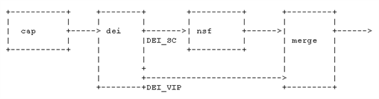

data flow:

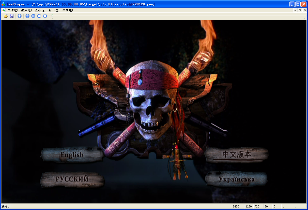

the output resolution of DEI_SC is the same as the input
I export YUV422 frame after caplink and YUV420 frame(date from DEI_SC) after merge link respectively
The image after cap link:
the image after merge link:(click the picture to zoom in)
Apparently, The quality of image after cap link is better than the one after merge link. I don't know why.
Someone give some help.

  • Pls explain you data flow. Are you getting progressive input and are using DEI just for scaling ?
    enableDeiForceBypass = TRUE is correct setting to bypass DEI.
    There are special scaler coefficients for 1:1 scaling which doesn't modify frame quality which is automatically selected in DVR RDK 4.0. Confirm you are using DVR RDK 4.0 release
  • “Are you getting progressive input and are using DEI just for scaling ?”
    Yes. and the scaler coefficients is 1:1

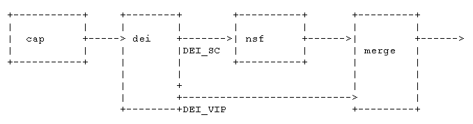

    I just modify the code to test. I must use DEI, because our product's need output two channel video data( DEI_SC and DEI_VIP) for one video input. DEI_SC's output resolution is the same as input which I don't need to do scaler; DEI_VIP is used to do scaler as user's wish.
    So my question is:
    1) Why the quality after the scalar is bad than before even if the output resolution is the same as the input? How to fix it?
    2) How to disable scaler at runtime in the DEI if I find the output resolution is the same as the input?
  • If you don't require scaling at all then the change you have done is correct.
    Another option is to dup the capture output and give one input to NSF link and another to DEI configured in single output configuration.
    The issue of artifacts is due to selection of wrong scaling coefficients. There exists a spl set of scaling coefficients for 1:1 scaling but DEI link is using downscaling if Output Resolution <= Input Resolution.
