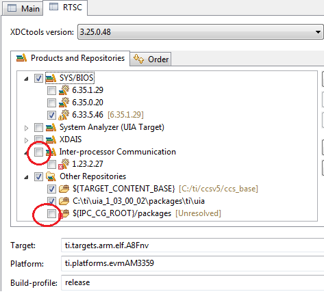

An warning message appear: See details below...   Unrecognized product of type 'com.ti.rtsc.IPC' is required by project 'i2c_led' - please install at least one product of this type before building this project.
Where i can find this ?
As an attachment a picture of my configuration:
  • Can you please post build console output. Also, please check if you have updated all necessary paths in project proprieties.
    Maciej
    i2c_led app doesn't really use IPC pakcage. This warning can be ignored. once the project is imported, go project properties->Genral->RTSC and uncheck IPC box.
    This was an issue with old sdk and is fixed in latest sdk 1.1.0.1.
    One more thing, you dont need to check <Copy Projects into Workspace> and <Automatically import referenced projects> unless you need to create new copy of the sample.

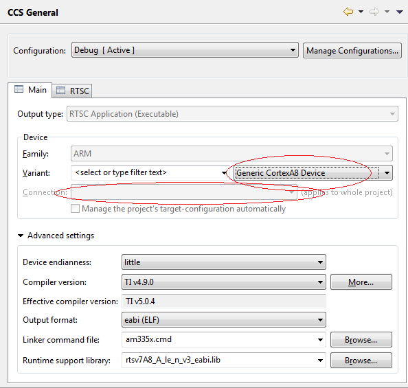

    2: I uncheck  as you said (the IPC_CG_ROOT check is also red):
    A question: in the project properties the compiler/Linker is a TMS470 based and not an ARMA8 compiler/Linker=>same family ?, so in the <processor options> the target processor is indexing with <7A8>, is it ok ?

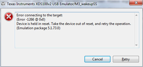

    A second question, In the <Debug properties>, what's the difference betwen <TexasInstruments XDS100v2 USB emulator/CortexA8> and <TexasInstruments XDS100v2 USB emulator/M3_wakeupSS> ?

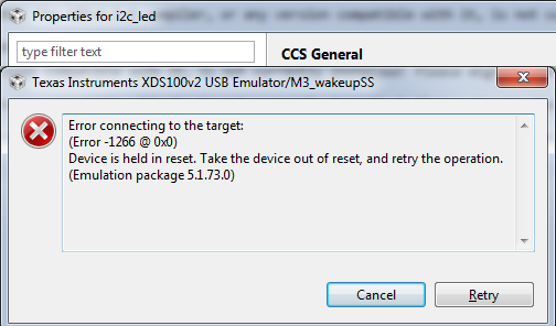

    4: Load and debug:

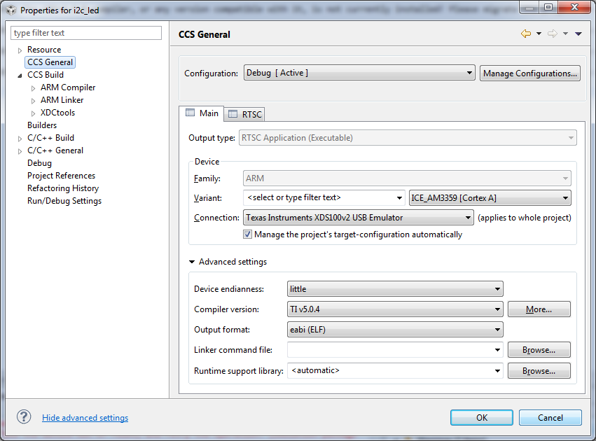

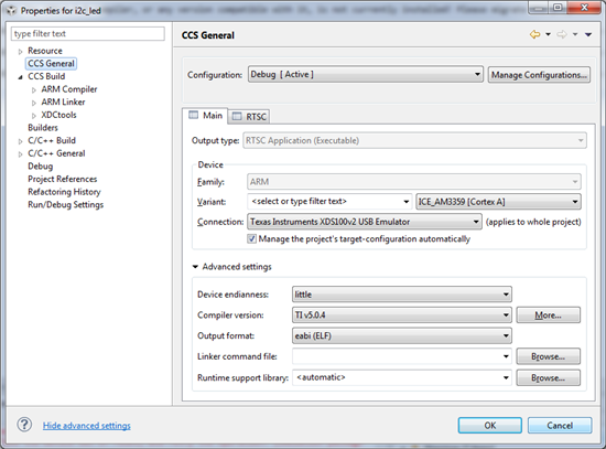

    I Search in the properties, in the CCS General properties there is no Connection selected:
    I replace the <Generic cortexA8 Device> by  <ICE_AM3359(CortexA)> and I select the TI XDS100v2 USB emulator, are you agree with my choice ?

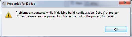

    If I close the window, a message box apear:
    The project.log file contains: !ERROR: The ARMv4.9.0 compiler, or any version compatible with it, is not currently installed! Please migrate the project to one of the supported compilers first.
    Sorry for my enormous post.Can you tell me where are my errors ? I am lost....

    I modify the options:
    The build is ok (only 2 littles warnings), but when I load the program, always the same error:
    An idea ?
  • You should connect to Cortex A8 instead of  M3 processor.
    Shahid

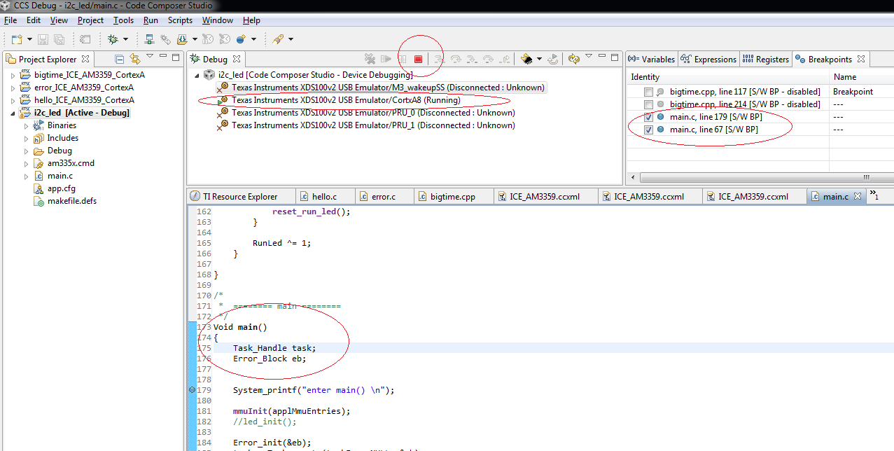

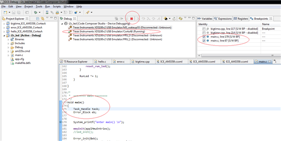

    This afternoon, impossible to repeat the operation, after the .gel is loaded, a curious behavior:
    The program seems to be loaded but it was not stopped at the start of the main:
    I leave CCS5, I reload and rebuild the project, nothing !!! same behavior with the other project: bigTime_ICE.
    Is CCS can provide me a report on the loading sequence ?
    Can anybody give me a direction how to resolve that problem ?
    Do the below always before loading application to the target. This should solve your problem.
    1. Suspend current program execution if any( CCS Menu->Run->Suspend)
    2. Do a hardware reset ( CCS Menu -> Run->Reset->Rest(HW) )
    3. Execute GEL initialization routine
    4. Load the application
    Shahid

    Yesterday, before reading you answer this morning, I deleted the BigTime project and reloaded/builded it, it's Ok now !!  After i loaded the I2c_led project, it's ok too. what append ?

    When you debug if the Memory map window is open (in the right bottom) , the error appear, if you close it, it's ok.I think that CCS try to inform the internal values before the CPu is ready, but i don't see the LR register in the list.
