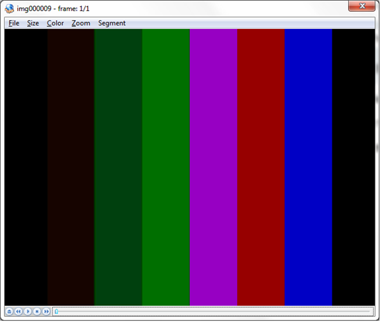

Hi!
I am trying capture image from camera OV5640.
My board is beagleboard-xM, Linux-3.3.7 from ti-sdk-beagleboard-06.00.00.00.
Camera output format is YUV422 UYVU.
Camera connection is:
Camera -> DM3730
d9 - d0 -> CAM_D9 - CAM_D0
static struct isp_v4l2_subdevs_group beagle_camera_subdevs[] = {
        .subdevs = ov5640_camera_subdevs,
        .interface = ISP_INTERFACE_PARALLEL,
        .bus = {
            .parallel = {
                 .data_lane_shift = 0,
                .clk_pol = 0,
                .hs_pol = 0,
                .vs_pol = 1,
                .bridge = 3,
I configure pipiline Sensor->CCDC->Memory, and capture image.
media-ctl -v -r -l '"ov5640 2-003c":0->"OMAP3 ISP CCDC":0[1], "OMAP3 ISP CCDC":1->"OMAP3 ISP CCDC output":0[1]'
media-ctl -v -f '"ov5640 2-003c":0 [Y10 640x480], "OMAP3 ISP CCDC":0 [Y10 640x480], "OMAP3 ISP CCDC":1 [Y10 640x480]'
yavta -p -f Y10 -s 640x480 -n 4 --skip 3 --capture=13 -F `media-ctl -e "OMAP3 ISP CCDC output"` --file=img#.raw
But color is not correct.

Am I missing something?
