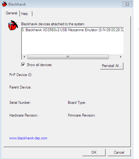

I have two TMS320C6670 board and i want to make a connection between CCS and each TMS320C6670 using Blackhawk XDS560v2-USB Mezzanine Emulator and i make this with one board but the other board has  a problem when i launch target configuration file progress hanged at 96% .

  • Hi Yooyama ,|
    Thank you for your answer ,
    I want to connect each board while the other is disconnected ,
    When board no.1 is connected and board no.2 is  disconnected i make an emulation on it  but when  board no.2 is connected and board no.1 is disconnected there is a problem in launching the target configuration file as i told before ,
    In the two cases Blackhawk control panel can detect the connection like the below image can you tell what is the problem please  ?
    Thanks in advanced ,
    Muhammad .

  • Hi Yokoyama ,
    first thank you for your effort with me ,
    I do this with another PC and there is the same problem ,
    but i notice that in the board no.1 (which work correctly) the three led(in the emulator board )  behind the RJ45 are on but the other led are off and
    the case in the board no.2 (which that is not worked ) the three led(in the emulator board )  behind the RJ45 are off but the other led are flashing
    from this notation do  you know what is the problem ?
    Thank you in advanced ,
    Muhammad
  • Hi Yokoyama, Atsushi
    i found that the board in the  safe mode (not working mode) and the steps for convert from safe mode to working mode at  this link
    http://e2e.ti.com/support/dsp/c6000_multi-core_dsps/f/639/t/180264.aspx
    Thanks for your effort with me ,
    Muhammad.
