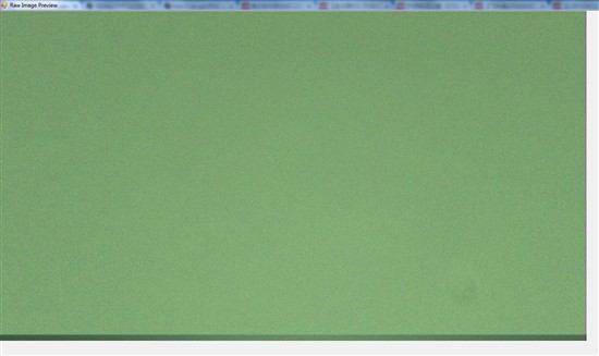

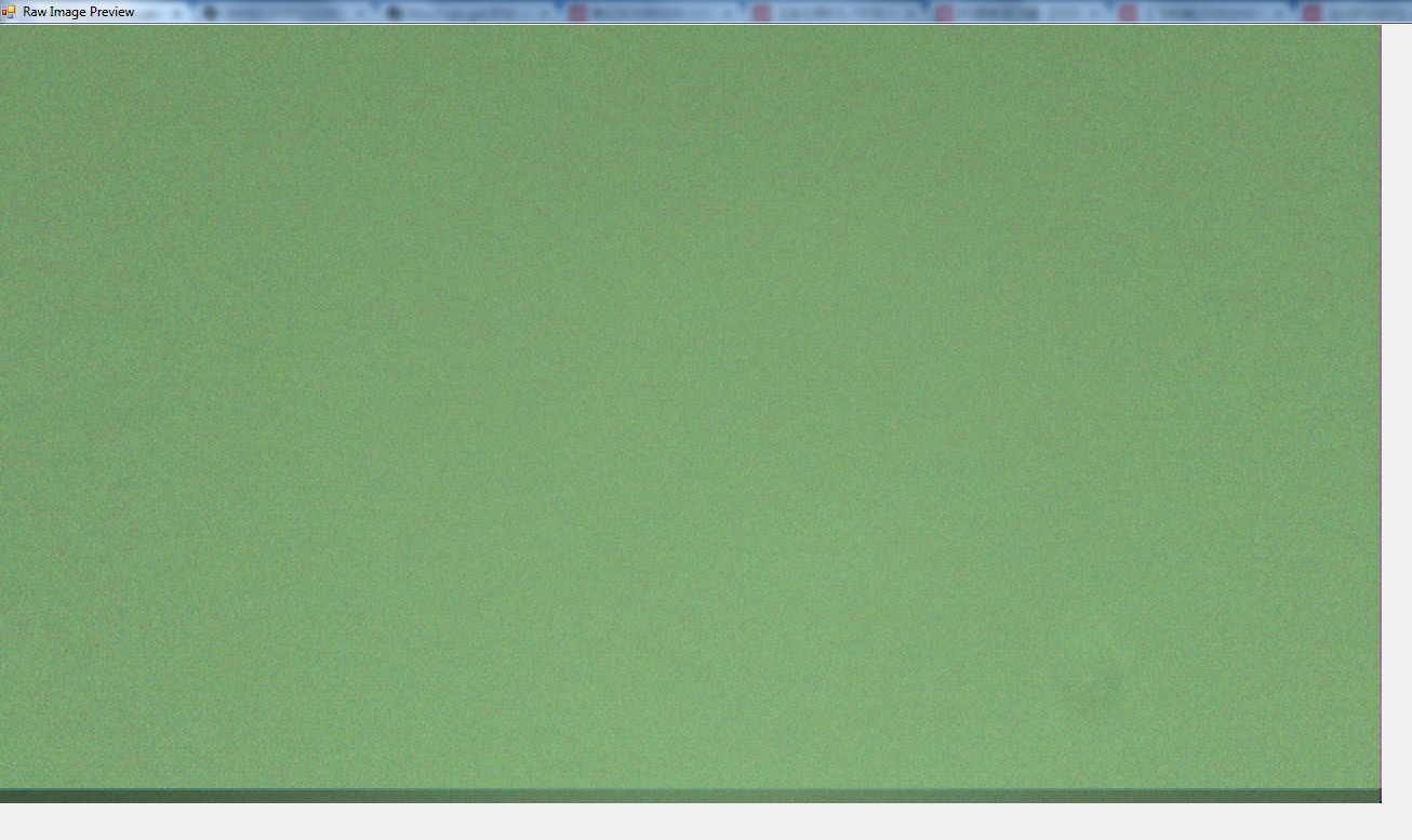

I'm developing a DM365+OV9712 project based on IPNC RDK 4.1.0 and met a problem after enable LSC.
After LSC tuning according to ITT user's guide and sending LSC parameters, lens shading get improved. but there is a dark area in the bottom part of image, as shown in below capture. There is no such dark area before LSC tuning. (Pls ignore the color as calibration and AWB is not done yet)
I tried to adjust the LSC parameters but it didn't help.
Could anyone help me and give suggestion? Thanks!

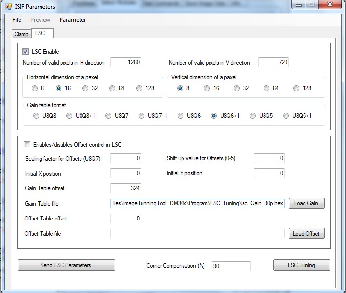

Below is my LSC parameters window after tuning finished:
GetFromCamera : ISIF LSC
enable :1
inWidth :1280
inHeight :720
paxelWidth :16
paxelHeight :8
gainFormat :5
offsetEnable :0
offsetScale :0
offsetShift :0
initX :0
initY :0
gainTableAddr :4777152
gainTableLineOffset :324
offsetTableAddr :4875456
offsetTableLineOffset :0
intSofEnable :0
intPreFetchErrorEnable :0
intDoneEnable :0
