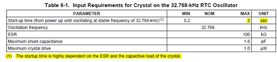

Is there any problem for device operation to assert of reset pin before not being stable RTC clock?
According to datasheet of C5535, Reset pin must be held low until all of the power supplies reach their operating voltage conditions.
So, I think that there is not any problem for the device operation to do it.

    What is the state of CLK_SEL pin?
    If CLK_SEL = 0, then RTC clock is used for SYSCLK during the bootloader.
    In that case, the RTC oscillator must be stable before being used. Time to stabilize depends on the ESR and  capacitive load of crystal. It can take up to 2 seconds.
    Mark

    CLK_SEL pin is "L". Thus, we need to tell customer that they need to wait until the RTC oscillator must be stable.

    The RTC oscillator parameters including worst case start up time 2s is in Table 6-1 of the datasheet.
    The datasheet is not clear about crystal stability before releasing reset, but this crystal app note from MSP430 has general information: http://www.ti.com/lit/an/slaa322b/slaa322b.pdf
    "Start-up times between several hundred milliseconds and a few seconds are normal values for low-frequency tuning-fork crystals, like 32768-Hz crystals."
    What is the state of DSP_LDO_EN? How long after power up does RESET assert low?
    I will file a datasheet bug to clarify RTC crystal stability requirements
