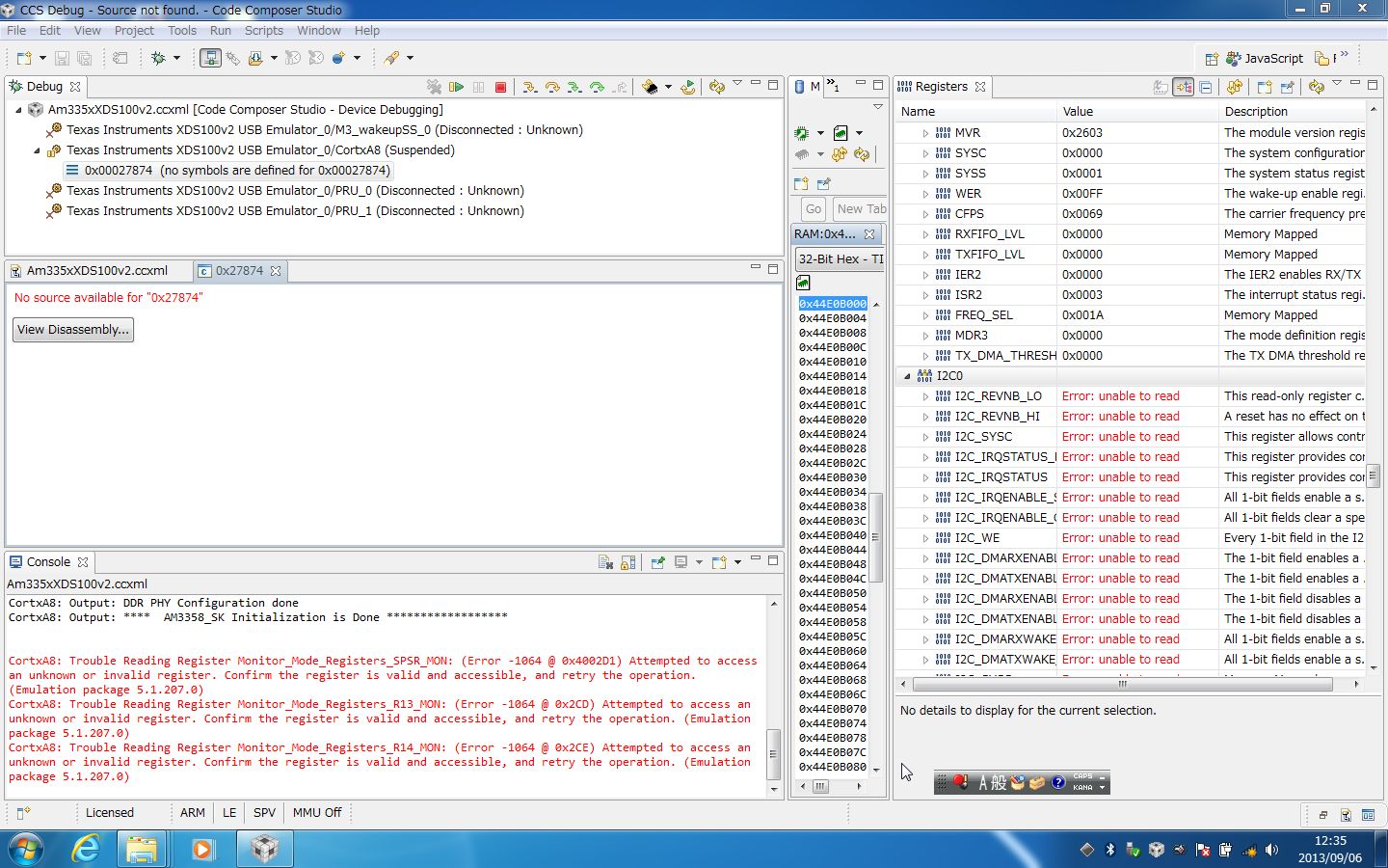

I can not connect to CortexA8 on AM335x Starter Kit with CCSv5.4.
The detail of my condition is as below.
Board:AM335x Starter Kit rev1.2b
     SD card is not  inserted
CCS:Ver5.4
XDS100v2:driver Ver 2.8.14.0
                    My distributor recommend to update XDS100v2 driver up to Ver2.8.30
PC:MacBookPro
OS:Windows7(64bit) with BootCamp
I can success "TestConnection".
 But,when I try to do "connect target" to CortexA8",then the connection is suspended.
I can see some registers,but I can not see another registers.
I attached the window shot.
BR,T.S

  • Dear All
    The issue is solved.
    PID=0x6010 is correct.I update a FTDI driver to be newest.
    The reason for I can not read I2C0 registers is PRCM setting.
    So I supply  function clock to I2C0. As a result, I can read I2C0 registers.
