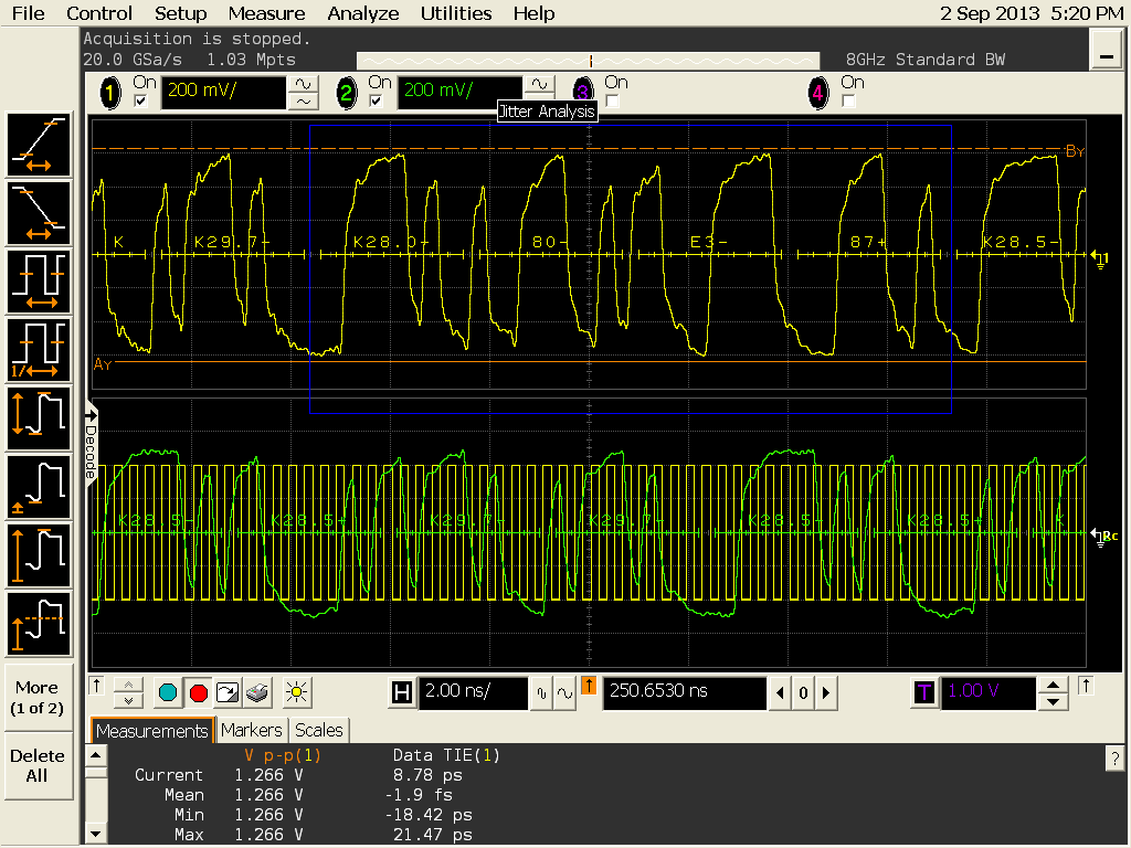

I inspected a wave form of SRIO output data from Keystone by the digital signal analyzer. I saw the control symbol which is enclosed by blue line in attached file. It's "K28.0 80 E3 87". Sometimes I can see it after PORT_OK.
"K28.0" is written the following description by SRIO-UG/2.1.2.3 Control Symbols. "This use of special characters provides an early warning of the contents of the control symbol." Does an early warning mean low signal integrity?
Also "80 E3 87" seems that the stype1 in 2nd byte is '011' and the cmd in 3rd byte is '100'. The stype1 is Restart-from-retry, but the cmd is Reserved. I didn't see that cmd is '000'. What does it mean?

    K28.0 is a special character that signifies a 'start of control symbol'. This character delimits a control symbol that does not contain a packet delimiter.
    Based on the Rapid IO spec, it looks like the cmd should be 0b000 for stype1 0b011 (restart-from-retry), as you stated. I noticed you mentioned 'low signal integrity' in your post, is this something you believe your system is encountering? Could this be causing an error in the data captured?

    It seems that there aren't any errors and retries. Sending K28.0 and sending restart-from-retry don't mean low signal integrity, do they?
    I have never seen 0b000 for cmd in stype1 0b011, but I sometimes see 0b100 for cmd in restart-from-retry after PORT_OK. I'd like to know reason why sending 0b100.

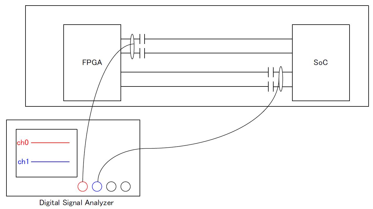

  • Hi Clinton,
    We use Digital Signal Analyzer performing the 8b10b decode.
    The device is TCI6614 connected to FPGA. The software is based on SRIO example code in PDK. The measuring point is between FPGA and AC coupling condenser. It means FPGA is receiving side.

  • Hi Clinton,
    Thanks a lot. It turned out that a root source is in FPGA. FPGA sent illegal response to Keyston. Then Keystone sent corrupt control symbol. I can't understand Keystone sent corrupt control symbol. But fixed FPGA and Keystone behaved correct communication. I think it's OK.
