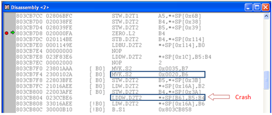

DW$L$_ManageExternalSensorsTID0$754$B:
       .dwpsn "ManageExternalSensors.c",3114,0
   [!B0]   B       .S1     L347              ; |3118|
|| [ B0]   LDW     .D2T2   *+SP(1448),B8     ; |3122|
|| [ B0]   MVK     .S2     32,B6             ; |3122|
   [ B0]   STW     .D2T2   B4,*+SP(232)      ; |3120|
|| [ B0]   MVK     .S2     53,B9             ; |3122|
   [ B0]   STW     .D2T2   B5,*+SP(236)      ; |3120|
           LDDW    .D2T2   *+SP[B6],B7:B6    ; |3122|
           LDDW    .D2T2   *+SP[B9],B5:B4    ; |3122|
   [!B0]   LDW     .D2T2   *+SP(1448),B6     ; |3127|
           ; BRANCHCC OCCURS {L347}          ; |3118|
DW$L$_ManageExternalSensorsTID0$754$E:
DW$L$_ManageExternalSensorsTID0$755$B:
           ADDAD   .D2     SP,B8,B2          ; |3122|
||         MVK     .S2     109,B1            ; |3122|
||         MV      .L2     B8,B0             ; |3122|
           NOP             2
           LDDW    .D2T2   *+B2[B1],B7:B6    ; |3122|
||         ADDDP   .L2     B7:B6,B5:B4,B5:B4 ; |3122|
           NOP             6
           SUBDP   .L2     B5:B4,B7:B6,B7:B6 ; |3122|
           ADDAD   .D2     SP,B0,B4          ; |3122|
           ADDK    .S2     496,B4            ; |3122|
           B       .S1     L348              ; |3124|
           NOP             3
           STW     .D2T2   B7,*+B4(4)        ; |3122|
           STW     .D2T2   B6,*B4            ; |3122|
           ; BRANCH OCCURS {L348}            ; |3124|
Below is corresponding Code:
Analyse is the following:
-          Test on B0 corresponds to “l_bStarterActif” test L 3122.
-          B.S1 occurs since “l_bStarterActif” is FALSE
-          It takes 6 cycles to branch so DSP continue to execute 6 following instructions.
          Affecting 0x0020 to B6 is conditioned to B0 value.
-          But using B6 as an offset isn’t conditioned to B0.
-          When B6 value is high (~larger than memory space), system crashes.
We did an other test changing –ms to -ms3 option.
-          Generated code is not the same
-          Result is the same
Below is .asm code.
DW$L$_ManageExternalSensorsTID0$689$B:
           ZERO    .L2     B4                ; |3115|
           STB     .D2T2   B4,*+SP(276)      ; |3115|
           LDBU    .D2T2   *+SP(276),B0      ; |3118|
           NOP             1
           LDDW    .D2T2   *+SP(224),B5:B4   ; |3120|
           NOP             2
   [ B0]   MVK     .S2     53,B7             ; |3122|
   [ B0]   LDW     .D2T2   *+SP(1448),B2     ; |3122|
           LDDW    .D2T2   *+SP[B6],B5:B4    ; |3122|
   [!B0]   B       .S1     L343              ; |3118|
           LDDW    .D2T2   *+SP[B7],B9:B8    ; |3122|
   [!B0]   MVK     .S2     54,B7             ; |3127|
   [!B0]   LDW     .D2T2   *+DP(_T_TK),B4    ; |3127|
   [!B0]   ADDAD   .D2     SP,B6,B6          ; |3127|
   [!B0]   LDDW    .D2T2   *+B6[B7],B7:B6    ; |3127|
           ; BRANCHCC OCCURS {L343}          ; |3118|
Below is assembler code.
In this case:
-          System still crashes
-          Branch is placed after stack read that causes system crash.
We did a third test using Full Symbolic Option
In this case, no optimation is done and all is ok!
