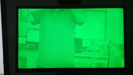

Capture a green video by DM8168 with a 8Bit-HD capture.
Other Parts Discussed in Thread: TVP5158
Hello,TI man.
Right now we migrate to DVRRDK 4.0 for its new feature,such as Swms can output YUV 4:2:0 video.But now we cann't get a normal video though 8Bit VIP port.
HD-SDI Camera---->GV7601(HD SDI Receiver)---->VIP0(A) (with discrete sync)
The upper is our hw diagram.
Now we get a following:
I think this is caused by captureLink for that after I send a "reboot" command to Dm8168,it can display "TI" logo normally.
Our code is :

I don't modify hdvpss driver or LinkAPI driver.All code written by us is executed by App layer.
Following is our Log:

Chain Select
Current System Settings,
NSF Mode : SNF + TNF
1: Multi CH Capture + NSF + DEI + Display (16CH 4x TVP5158, NTSC, YUV422I )
2: Multi CH Src + Enc + Dec + Snk (VideoM3 chain) (VideoM3 local loopBack)
3: Multi CH Cap + NF + Enc + Dec + SW (DEI/H,SC5) + Disp (16CH Cap+Enc+Dec+Disp, Interlace Enc/Dec)
4: Multi CH Cap + NF + DEI/H + Enc + Dec + SW (SC5) + Disp (16CH Cap+Enc+Dec+Disp, Progressive Enc/Dec)
s: System Settings
x: Exit
Enter Choice: 1
wangquan
SUITJUNE DM8168-c6678!!!
[m3vpss ] 5093: CAPTURE: Create in progress !!!
[m3vpss ] 5122: CAPTURE: VIP0 PortA capture mode is [ 8-bit, Non-mux Discrete Sync - ACTVID_VSYNC] !!!
[m3vpss ] 5430: CAPTURE: VIP0 PortB capture mode is [ 8-bit, Non-mux Discrete Sync - ACTVID_VSYNC] !!!
[m3vpss ] UTILS: DMA: Allocated CH (TCC) = 58 (58)
[m3vpss ] UTILS: DMA: 0 of 4: Allocated PaRAM = 58 (0x49004740)
[m3vpss ] UTILS: DMA: 1 of 4: Allocated PaRAM = 64 (0x49004800)
[m3vpss ] UTILS: DMA: 2 of 4: Allocated PaRAM = 65 (0x49004820)
[m3vpss ] UTILS: DMA: 3 of 4: Allocated PaRAM = 66 (0x49004840)
[m3vpss ] CAPTURE::HEAPID:0 USED:520
[m3vpss ] CAPTURE::HEAPID:4 USED:136857600
[m3vpss ] 5738: CAPTURE: Create Done !!!
[m3vpss ] 5740: DISPLAY: Create in progress !!!
[m3vpss ] 5741: DISPLAY: Create Done !!!
[m3vpss ] 5741: DISPLAY: Create in progress !!!
[m3vpss ] 5742: DISPLAY: Create Done !!!
[m3vpss ] 5743: DISPLAY: Start in progress !!!
[m3vpss ] 5873: DISPLAY: Start Done !!!
[m3vpss ] 5873: DISPLAY: HDDAC(BP0) : 15 fps, Latency (Min / Max) = ( 255 / 0 ), Callback Interval (Min / Max) = ( 255 / 0 ) DropCount:0 DispLatency (Min / Max) = ( 7811 / 0 ) !!!
[m3vpss ] 5873: DISPLAY DRV: HDDAC(BP0) : Q:[2] Display:[2], Repeat:[1], DQ:[0]
[m3vpss ] 5873: DISPLAY: UNDERFLOW COUNT: HDMI(BP0) 1, HDDAC(BP0) 0, DVO2(BP1) 1, SDDAC(SEC1) 1
[m3vpss ] 5874: SYSTEM : FREE SPACE : System Heap = 67792 B, Mbx = 10238 msgs)
[m3vpss ] 5874: SYSTEM : FREE SPACE : SR0 Heap = 16840192 B (16 MB)
[m3vpss ] 5874: SYSTEM : FREE SPACE : Frame Buffer = 529920896 B (505 MB)
[m3vpss ] 5874: SYSTEM : FREE SPACE : Bitstream Buffer = 291504000 B (277 MB)
[m3vpss ] 5874: DISPLAY: Start in progress !!!
[m3vpss ] TILER_STATS: CNT :8BIT
[m3vpss ] TILER_STATS: CNT RESOLUTION: 16384 x 8192
[m3vpss ] TILER_STATS: BUCKET RESOLUTION: 16384 x 8188
[m3vpss ] TILER_STATS: NUM FREE BUCKETS: 1
[m3vpss ] TILER_STATS: NUM USED BUCKETS: 0
[m3vpss ] TILER_STATS: TOTAL FREE AREA: 134152192 (99 %)
[m3vpss ] TILER_STATS: TOTAL USED AREA: 0 (0 %)
[m3vpss ] TILER_STATS: CNT :16BIT
[m3vpss ] TILER_STATS: CNT RESOLUTION: 32768 x 4096
[m3vpss ] TILER_STATS: BUCKET RESOLUTION: 32768 x 4096
Chains Run-time Menu
0: Stop Chain
s: Switch Display Layout (Sequential change of layout)
c: Switch Display Channel (Sequential: Increments by 1)
p: Print Capture Statistics
b: Modify Encoder Bit Rate
f: Modify Encoder Frame Rate
r: Modify Intra Frame Interval(GOP)
t: Toggle force IDR frame
g: Print Encoder Dynamic Parameters
i: Print IVA-HD Statistics
m: Print SwMs Statistics
a: Audio Capture / Playback
Enter Choice: [m3vpss ] TILER_STATS: TOTAL FREE AREA: 134217728 (100 %)
[m3vpss ] 5876: SYSTEM : FREE SPACE : Tiler 8-bit = 134152192 B (127 MB) - TILER ON
[m3vpss ] 5876: SYSTEM : FREE SPACE : Tiler 16-bit = 134217728 B (128 MB) - TILER ON
[m3vpss ] 6006: DISPLAY: Start Done !!!
[m3vpss ] 6007: DISPLAY: DVO2(BP1) : 15 fps, Latency (Min / Max) = ( 255 / 0 ), Callback Interval (Min / Max) = ( 255 / 0 ) DropCount:0 DispLatency (Min / Max) = ( 7811 / 0 ) !!!
[m3vpss ] 6007: CAPTURE: Start in progress !!!
[m3vpss ] 6007: DISPLAY DRV: DVO2(BP1) : Q:[2] Display:[2], Repeat:[1], DQ:[0]
[m3vpss ] 6106: CAPTURE: Enabled Time Stamping !!!
[m3vpss ] 6114: CAPTURE: Enabled Time Stamping !!!
[m3vpss ] 6122: CAPTURE: Start Done !!!
p
Enter Choice: [m3vpss ] *** Capture Driver Advanced Statistics ***
[m3vpss ]
[m3vpss ] VIP Parser Reset Count : 0
[m3vpss ]
[m3vpss ] | Total Even Odd Total Even Odd Min / Max Min / Max Dropped Fid Repeat Frame Error Y/C
[m3vpss ] CH | Fields Fields Fields FPS FPS FPS Width Height Fields Count (Desc Error Y/C)
[m3vpss ] ------------------------------------------------------------------------------------------------------------
[m3vpss ] 000 | 186 186 0 31 31 0 1920 / 1920 1080 / 1080 1 0 0/0 (0/0)
[m3vpss ] 100 | 1 1 0 0 0 0 65535 / 0 65535 / 0 1 0 0/0 (0/0)
[m3vpss ]
[m3vpss ] VIP Capture Port 0 | DescMissMatch1 = 0, DescMissMatch2 = 0 , DescMissMatch3 = 0
[m3vpss ] VIP Capture Port 1 | DescMissMatch1 = 0, DescMissMatch2 = 0 , DescMissMatch3 = 0
[m3vpss ]
[m3vpss ] *** Capture List Manager Advanced Statistics ***
[m3vpss ]
[m3vpss ] List Post Count : 1553
[m3vpss ] List Stall Count : 0
[m3vpss ] List Post Time (ms) : Max = 0, Min = 0, Avg = 0, Total = 0
[m3vpss ] INTC Timeout Count : (0, 0) (Min timeout value = 991, 1000)
[m3vpss ] Descriptor miss found count : 0
[m3vpss ]
[m3vpss ]
[m3vpss ] VIP and VPDMA registers,
[m3vpss ] VIP0 : FIQ_STATUS : 0x4810551c = 0x00000000
[m3vpss ] VIP1 : FIQ_STATUS : 0x48105a1c = 0x00000000
[m3vpss ] VPDMA: LIST_BUSY : 0x4810d00c = 0x00060000
[m3vpss ]
[m3vpss ]
[m3vpss ] 12324: CAPTURE: Fields = 184 (fps = 29, CPU Load = 0)
[m3vpss ] 12324: CAPTURE: Num Resets = 0 (Avg 0 ms per reset)
[m3vpss ] 12324: SYSTEM : FREE SPACE : System Heap = 67792 B, Mbx = 10238 msgs)
[m3vpss ] 12324: SYSTEM : FREE SPACE : SR0 Heap = 16840192 B (16 MB)
[m3vpss ] 12325: SYSTEM : FREE SPACE : Frame Buffer = 529920896 B (505 MB)
[m3vpss ] 12325: SYSTEM : FREE SPACE : Bitstream Buffer = 291504000 B (277 MB)
[m3vpss ] 12326: SYSTEM : FREE SPACE : Tiler 8-bit = 134152192 B (127 MB) - TILER ON
[m3vpss ] 12326: SYSTEM : FREE SPACE : Tiler 16-bit = 134217728 B (128 MB) - TILER ON
expectin for any reply.I have been stuck for more than a week.
  • Pls first run decode_display usecase on your board and confirm it is not issue with display
    Next dump VIP0 registers for the working case (older release) and non-working case (new release)
    Dump 100 registers (100 32 bit values) from VIP0 address of 0x48105500
    You can use devmem2 or mem_rdwr.out (mem_rdwr.out can be found under /opt/dvr_rdk/816x/bin)
