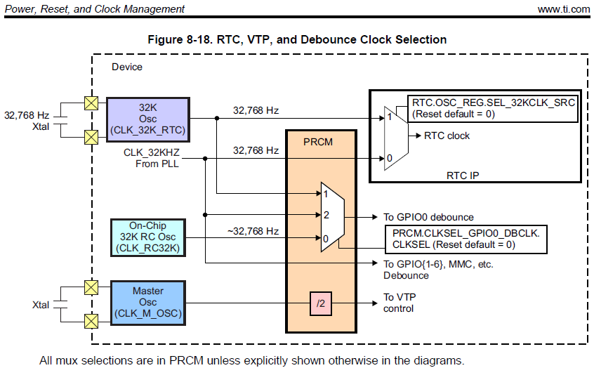

  • Hello Biser,
    Thank you for the response. But it does not answer my question. Let me put in a clear way.
    (1) Can we use the internal RC Oscillator for RTC purpose? (Even if the accuracy is less, it is not a problem)
    (2) AM335x Datasheet, section 6.2.1 says that RTC can be configured to receive clock from internal RC Oscillator. Please see the snapshot below. Is it true?
    Thanks and regards,
    Paul
  • Yes, you can. This is the default setting.
  • Hello Biser,
    Then could you please tell us how to do that?
    We could not see any options in the Clock Tree tool or in the TRM. Also we see a contradictory block diagram in TRM where there is no option to connect the internal RC Oscillator to the RTC block. Please find below.
    Thanks and regards,
    Paul
  • Sorry, sorry, sorry... I was misguiding you. The RC oscillator is not available for the RTC, it can be used with the WDT and DMTimer0. The RTC can be clocked either from the external crystal/oscillator, or from a dedicated divider from the Peripheral PLL.
