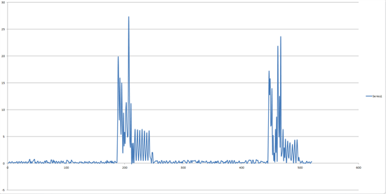

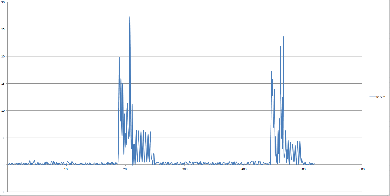

    We have one more question:Is it possible that the auto-contrast or noise filters are turned on in the TVP5158 by default?
    We have the  DSP calculate the dispersion for a zone.  this value is then compared to the next adjacent frame.  if the frames don't change this compare would be 0. There is an obvious oscillation after an image moves through the zone.  Attached is the graph that shows the oscillation.
    What do you think is causing the oscillation? Any help is appreciated.
    Shilpa.
  • Badri,
    To debug the oscillation issue, we created a 13 second test pattern video with an impulse for about 10 frames at the 7th second.In our custom DSP link, all we do is collect and print a small window of framedata to syslog.This data is difference between two frames.
    Sample Data without oscillation
    0.010000 0.140000 0.110000 0.010000 0.130000
     0.200000 0.260000 0.070000 0.190000 0.040000
     0.010000 0.020000 0.190000 0.040000 0.120000
     0.010000 0.050000 0.080000 0.050000 0.070000
     0.020000 0.000000 0.100000 0.110000 0.060000
     0.050000 0.100000 0.040000 0.040000 0.040000
     0.070000 0.020000 0.030000 0.130000 0.080000
     0.030000 0.020000 0.020000 0.010000 50.810001
     1.980000 11.730000 64.400002 0.030000 0.050000
     0.290000 0.230000 0.030000 0.110000 0.010000
     0.120000 0.030000 0.080000 0.000000 0.010000
     0.000000 0.050000 0.090000 0.160000 0.030000
     0.070000 0.070000 0.020000 0.030000 0.060000
     0.180000 0.080000 0.160000 0.020000 0.040000
     0.160000 0.130000 0.190000 0.340000 0.030000
    Sample Data with oscillation
      0.330000 0.340000 0.440000 0.380000 0.100000
      0.030000 0.140000 0.370000 0.230000 0.190000
      0.500000 0.260000 0.000000 0.190000 0.020000
      0.020000 0.320000 0.200000 0.010000 0.030000
      0.050000 0.260000 0.260000 0.040000 0.040000
      0.120000 0.110000 0.220000 0.480000 0.210000
      0.000000 0.140000 0.020000 0.040000 0.110000
      0.060000 0.050000 0.070000 0.010000 0.020000
      0.030000 0.130000 0.190000 0.010000 0.030000
      0.010000 0.150000 0.080000 0.090000 0.050000
     0.050000 0.040000 0.140000 65.190002 1.080000
     13.570000 50.480000 0.070000 0.120000 6.030000
     5.970000 0.040000 0.010000 4.300000 4.440000
     0.000000 0.020000 2.740000 2.410000 0.230000
     0.030000 2.530000 2.500000 0.030000 0.130000
     2.700000 2.700000 0.090000 0.060000 2.820000
      2.790000 0.000000 0.010000 2.690000 2.570000
      0.120000 0.000000 2.820000 2.750000 0.100000
      0.030000 0.140000 0.120000 0.080000 0.160000
      0.070000 0.050000 0.050000 0.050000 0.100000
      0.130000 0.060000 0.000000 0.040000 0.070000
      0.000000 0.040000 0.020000 0.030000 0.090000
      0.010000 0.030000 0.010000 0.010000 0.040000
    The problem we are seeing is that after the impulse occurs, the buffer data oscillates before it is stable. This is totally random. We are assuming that we are not setting some parameter in the chain correctly but we donot know which one and on which link. Thank you for your help.
    Shilpa.
  • Badri,
    We found out that the problem was a cache coherency issue. We were not invalidating the D-cache at our DSP link  after copying the frame data. Thanks for all your help.
    Shilpa
