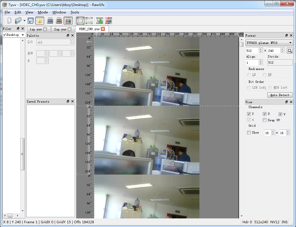

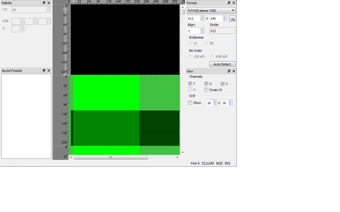

  • Hi Badri,
    I use black video to test. I open the yuv file and the following is the picture.
    It seems the buffer addr used to write is not right. Do you know what's the problem?
  • What API are you using to get the video Frames on A8 ? The image looks like you are trying to open YUV420 file in some other format.
    Can you mention width,height pitch of the frame received on A8 and attach the YUV file.

  • Does your YUV viewer support YUV 420 SP format viewing ?

  • Yes,  I use 7yuv and it supports 420SP format. I check the pMemVirtAddr converted from pBuf->phyAddr[0][0] and find the buffer size of pBuf is 294912 = 512*576. Why is 576?
  • You should only use pitch x height. Use of any other value for frameSize is wrong.

    I opened the YUV file you shard in a YUV viewer that _does_not_ support 420SP and it looks the same as the image you shared so confirm you are really configuring your YUV viewer for 420SP display.
    The pitch for the YUV frame looks to 512 which is correct.
    The height in the image looks wrong. Print the pitch and confirm it is 512.
    The decoder output will  have startX startY and displayed image should crop the startX, startY.

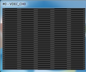

  • Hi Badri,
    I do some test and find some result. When I use the following codes to save the yuv data I could open it in 7yuv setting width and height to 512x240. The picture shows correctly and I could encode the yuv file to h264 file successfully using x264. The actual video res is 368x240 as you can see there is 8 pix on the left side and 136 pix on the right side.
    Then how could I get the right res? Why the frame width is changed?

  • As I mentioned previously you should use startX, startY of 32,24  . The output buffer pitch is 512 and is not related to the actual image width. If you want to copy only the image write a loop like below to copy luma.:

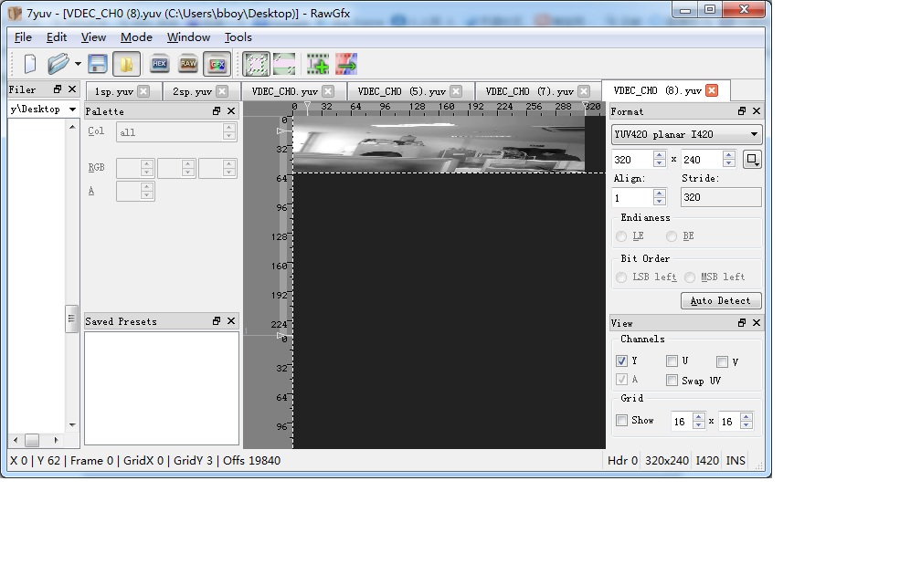

  • Hi Badri,
    When I use startX and startY to save the image, whatever value I use I always get the following errors after the for loop run a few times. When I set startX=8 and startY=0, the following codes run 62 times before get error.
                    pictureBaseAddress = pMemVirtAddr;
                    for (LineIdx = 0 ; LineIdx < pBuf->frameHeight; LineIdx++)
                        lineStartAddress = (UInt32 *)pictureBaseAddress + ((startY + LineIdx) * pBuf->framePitch[0]) + startX;
                        fwrite(lineStartAddress, 1, pBuf->frameWidth, gVdecVenc_ctrl.fp);
                        printf("index is %d\n", LineIdx);
     There is something wrong with the address.

    I open the output yuv file in 7yuv and set the res to 320x240. The luma width is 320 and height is just 62. So I think if the loop could run successfully the output luma should be correct.
  • Can you try
    pictureBaseAddress = (UInt8 *)pictureBaseAddress + ((startY * framePitch[0]) + startX);
     for (IineIdx = 0 ; IineIdx < frameHeight; IineIdx++)
       lineStartAddress = (UInt8 *)pictureBaseAddress + (lineIdx * framePitch);
       fwrite(lineStartAddress, 1, frameWidth, gVdecVenc_ctrl.fp);

  • Hi Badri,
    I find the issue. For chroma, the startY should be 12. Now the saved yuv file is correct.
