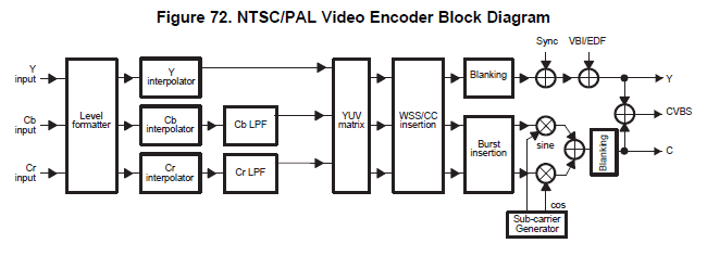

The project I am designing now is DM368-based which needs to output NTSC-RS170 video wisgnal.
RS170 is a monochrome NTSC video signal.
I referred to sprufg9c.pdf (below liink).
http://www.ti.com/general/docs/lit/getliterature.tsp?baseLiteratureNumber=SPRUFG9&track=no
On page 113, Figure 72 illustrates that the sub-carrier is blended to chroma signals.
Question:
Is it possible to disable sub-carrier generator or to cut off chroma signal from the mixer of CVBS output ?
