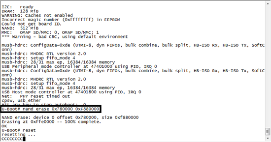

hi,
    now we are using am3359 and SPANSION flash S34MLO4G100TF100 , and the SYSBOOT[4:0] is set to 00100.
    it can boot from UART,MMC0 and NAND normally, but we found that if we write/erase the flash, it can't boot from nand, the terminal stoped at 'CCCCCC'
the picture shows when boot from flash, we erase the filesystem area, then reset the board, it stoped at CC.
at this time, if we power down the board, then power up it (using TPS65910), the board can boot normally
