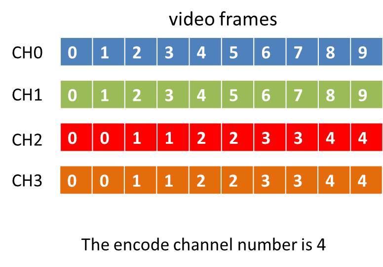

I create a fileread->encode->filewrite usecase, I use the following steps to feed yuv data to encode input.
0. VdecVdis_ipcFramesFillBufInfo()
1. read yuv data from input file
2. Vdis_putFullVideoFrames()
3. Vdis_getEmptyVideoFrames()
4. VdecVdis_ipcFramesFreeFrameBuf()
I use the following steps to get h264 data from encode output.
0. Venc_getBitstreamBuffer()
1. write h264 data to file
2. Venc_releaseBitstreamBuffer()
Now the program could run successfully. But once I feed one frame per channel to encode input I will get newdata available callback twice and if the encode channel number are more than 2, the channel index larger than 1 will have each frames twice. The following figure will show the situation.
I don't know why this happens, could someone give me some advise?

  • Your application code is wrong.
    IpcFramesFillBufInfo will populate only those channels which have frameObj[i].refCnt == 0.
    But when reading from file you are doing
    for(i=0; i<ENC_CH; i++)
    				fread((unsigned char *)(bufList.frames[i].addr[0][0]), 1, gReadYUVConfig.width * gReadYUVConfig.height, gReadYUVConfig.fin[i]);
    				fread((unsigned char *)(bufList.frames[i].addr[0][1]), 1, gReadYUVConfig.width * gReadYUVConfig.height * 0.5, gReadYUVConfig.fin[i]);
    				if(feof(gReadYUVConfig.fin[i]))
    					fseek(gReadYUVConfig.fin[i], 0, SEEK_SET);
    Correct code should be
    		if(bufList.numFrames)
    		    //printf("0rfcnt is %d\n", frmObj[1].refCnt);
    			for(i=0; i<bufList.numFrames; i++)
    				fread((unsigned char *)(bufList.frames[i].addr[0][0]), 1, gReadYUVConfig.width * gReadYUVConfig.height, gReadYUVConfig.fin[bufList.frames[i].channelNum]);
    				fread((unsigned char *)(bufList.frames[i].addr[0][1]), 1, gReadYUVConfig.width * gReadYUVConfig.height * 0.5, gReadYUVConfig.fin[bufList.frames[i].channelNum]);
    				if(feof(gReadYUVConfig.fin[bufList.frames[i].channelNum]))
    					fseek(gReadYUVConfig.fin[bufList.frames[i].channelNum], 0, SEEK_SET);
    			printf("feed buflist to encode\n");
    			status = Venc_putFullVideoFrames(&bufList);
          		OSA_assert(0 == status);

    I apply the changes as you said, But the result is just the same. The channels beyond 2 still have each frame twice. In my codes, I assign one frameObj for each channel, the bufList.frame[i] is corresponding to channel i. So the above   two  sections of codes are the same.
    I wonder if it is something wrong with IpcFramesFreeFrameBuf() function. It seems that those channels who have each frame twice do not release the input buffer properly.

    I find the issue. In FileFD_ipcBitsProcessFullBufs() function, After get encode output bufList I should use fullBufList.numBufs to limit the loop time. I use ENC_CH for mistake.
    Thanks so much for your kindly  help!
