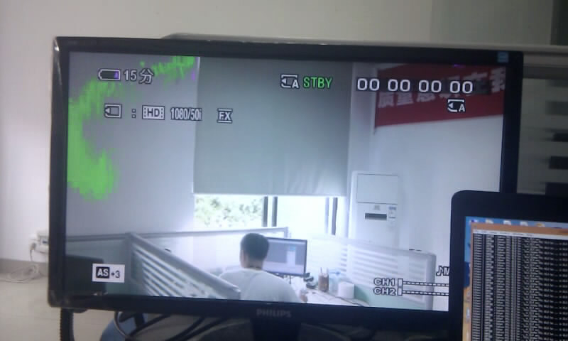

DVR RDK 4.0 1080i interlaced encoding + decoding sometimes show green mosaic
I am using DVR RDK 4.0 to do capture + encoding + decoding + display.
When the video source is 1080p@30Hz, the video is very good.

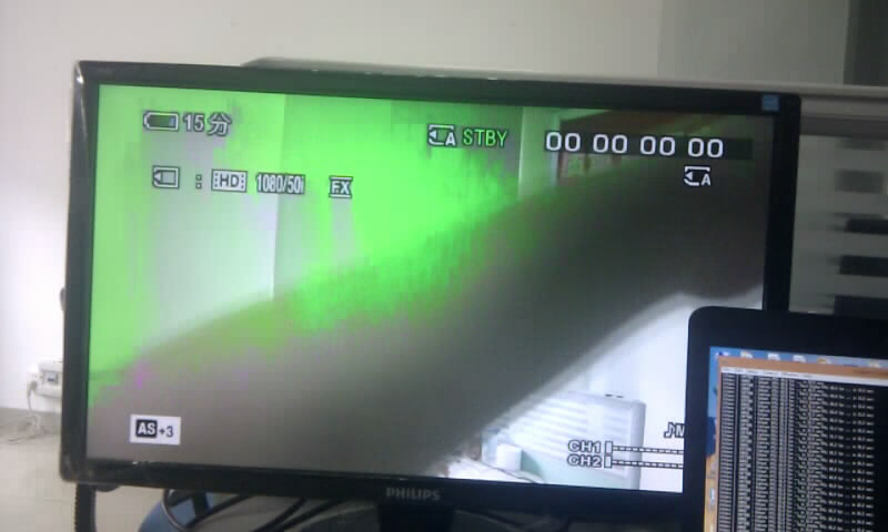

When the video source is 1080i@60Hz, I set "fieldMergeEncodeEnable = FALSE, DecPrm.processCallLevel = FIELD_LEVEL" and I can see good video in most of the time. But when the picture starts to move, i will probably see green mosaic. Please see it in attached pictures.
As I know, we may have a new release to have better support on interlaced encoding and decoding in Sep. Did we have newer version DVR RDK now? If not, when will we have it?
Could you please help to guide me how to solve such issue?

  • Hi Badri,
    This 1080i60 h264 file can be played well on PC with VLC. Video is good. But the TI decoder will have green mosaic. I tried the demo dec display user case, it is the same as my user case.

  • Looks like you have some sort of pixel-based alpha blending or transparency enabled. Are you using V4L2 or FBDEV to blend your multiple framebuffers?
    Ralph
  • We were able to recreate the issue on DVR RDK with the stream provided. It looks like the issue is with reference buffer size or alignment. We are currently debugging this. Issue is not seen if you create decoder channel for tiled memory output. Pls check if this is the same behavior in your application as well.We will update this post once the issue is resolved.

  • Attached patch should resolve the issue
