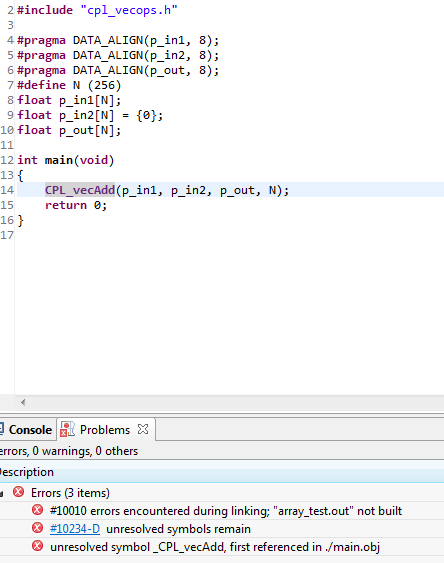

I am currently developing ASP algorithms on DA830 EVM. I found there are some library functions provided with PA/F such as CPL_vecAdd and CPL_fft, but I cannot find the documents or examples on them. Can you provide me some materials about those functions? Thanks!
I have created a simple example to call CPL_vecAdd:

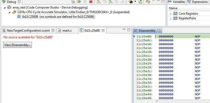

 It was failed. When I call function void CPL_vecAdd_(float *pIn1, float *pIn2, float *pOut, int n), it can be built successfully. But when I run this example in simulator, it was failed. The error information is as follow:
How can I run those CPL_ functions in simulator? Thanks!
