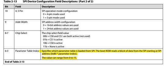

I have questions on how to properly set  pull-ups and pull-downs on the GPIO in order to correctly configure SPI boot on 6678.
1)      As shown in table 2-11 of TMS320C6678 data manual, in the SPI booting device configuration setup section, Bit 8-7 is for chip select field value setup. Can somone point us which document we should look to find definition of those bits? My guess is that these two bits define which chip select to use, but since two bits define 4 numbers and there are two chip selects, which is proper value to select /CS0?
2)  I have an issue with Bits 6-3, parameter table index.  What is parameter table index? Where can I find the parameter table definition? I searched and searched all zillion pdf documents and I did not find the definition. Could someone point me to the document which I should read, or even better tell me what is proper configuration for those bits for SPI flash boot?

  • 1.) I assume you mean Table 2-13 as that is the SPI Device Configuration for Boot Table, while Table 2-11 is for I2C Device Configuration.  Bit's 8-7 Correspond to SPICS[1:0]
    2.) The Boot Parameter Table is documented in the Boot Loader User Guide - http://www.ti.com/lit/ug/sprugy5c/sprugy5c.pdf

  • Thank you for the replay but I did not any answer to my questions. Perhaps I was not clear what I do not understand.
    First, in the documat I have it is table 2-11 (document SPRS689D.pdf). This same table is duplicated in boot loader guide where it is labeled as Table 3-29 (SPRUGY5B.pdf). Second, I do know what is the name of those two bits, I do not know what values to use. For example a well written user guide would not say in the bit description:
    "0-3 = The chip select field value" (what the hack is field value?).
    Instead it would say:
    "0 - selects /CS0 for booting operation" (so it is clear that I have to connect /CS0 to the SPI flash CS for booting).
    "1 - selects /CS1 for booting operation"
    "2 - reserved for future use"
    "3 - reserved for future use"
    I do not know if there are other Keystone DSPs that have SPI interface with 4 chip select or not. So, I ask again, what number to put there if I have boot SPI flash connected to /CS0?
    Regarding my second question, the document you pointed out does not give me an answer either. There are four GPIO bits (GPIO4 to GPIO7)  that are read into "Parameter Index" field of SPI boot mode configuration register. The documentation says:
    "Parameter Table Index | 0-3 = Specifies which parameter table is loaded"
    How does that explain me what to do with the GPIO pins? Which should be pulled up and which should be pulled down? Do I need to have intimate knowledge how Code Composer Studio packs boot image for SPI flash booting in order to figure that one out? That is hopeless. I do not want to go into CCS details. All I want to know is how to pull-up / pull-down GPIO4 to GPIO7 bits that are mapped to SPI Device Configuration Field, bits 3 to 6 in order to have 6678 boot properly from SPI flash. Can anyone give me straight answer please?

    Sorry for the delayed response on this thread.There is a literature bug (SDOCM00103122)filed against this and we are working to resolve the issue. This is how the DEVSTAT bit line up for the SPI boot

    Chip select 0 is picked by default from the boot mode pins which get latched to the DEVSTAT register as described in the data manual. The only values  0b10 (cs0 low) or 0b01 (cs1 low) are valid.
    For details, you can look at the tiboot.h file provided as part of the bootloader examples in the MCSDK 2.x ( \mcsdk_2_01_02_05\tools\boot_loader\ibl\src\device)or the source of the ROM code(section Keystone ROM Boot Examples and Reference code ) that we provide here :

    I got eval board schematic so I figured it out.
    One remaing question are GPIO bits 14 and 15.  The table have dip switches in "on" position which means GPIO pins are pulled low. In our design, we use GPIO14 and 15 as inputs that are by default driven high.  I could not find if those two bits matter for the SPI boot. If they do we have to add tristate buffers so we can have themn pulled low. If they do not, then there is no need to change anything.  Do they need to be pulled low for SPI boot?
  • Hi Slobodan,
    Thanks for the update and glad you could find the required hook ups. GPIO 14 and GPIO15 are not boot related switches. They are switches that select the the PCIESS mode0 and PCIESS mode 1 so unless you want to select a specific PCIE mode they, should be don`t care from boot perspective.
