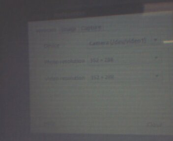

    I also noticed that the /dev folder in the device doesn't have the video device defined.
    This issue could be a simple configuration issue
    The camera resolution is 352x288. Attach is a picture I took from the camera via Cheese
    Also is attach is the TI - Sitara Build Info
    Note; The TI-Sitara-SK is recognizing the camera. Attach is a terminal log of connecting and disconnecting the usb camera

  • Mahendra,
    Yes, the logs indicate that the /dev/video node is not getting created. I suspect this could be a setup issue. Can you also test with Am335xEVM?
    I tested with Logitech USB camera on AM335x SK(Android 4.2.2). The preview and capture works fine.
    Attached is the image.
    USB connect/disconnect logs

  • I also notice that after connect/disconnect of USB camera, the video node changes from /dev/video0 to /dev/video1.
    But in Camera HAL, the video node is specified as /dev/video0

    I have a USB uvc camera working but or some reason I can only get capture resolutions like 320x240. Did you succeed getting larger resolutions?
  • It was a problem with the camera device. After changing the device I could get larger images.
