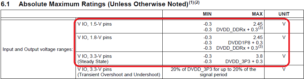

I have an confirmation about DM8167 Absolute Maximum Ratings.
There are two or three requirements by each IO pins.
It means that we need to satisfy all of them. Right?
Best regards, RY
sprs614d.pdf (P136)
  • In my experience with these things it's always best to be on the safe side and match all requirements.
  • Hi, _Ralph_.
    I think so. Thank you so much for your advice!
    Hi, TI'er.
    Are our thinking correct?
    Best regards, RY
  • Absolute max is exactly that... absolute. You should never, ever exceed the absolute max values.
    These are NOT normal operating conditions. Do NOT target these values under normal operating conditions.

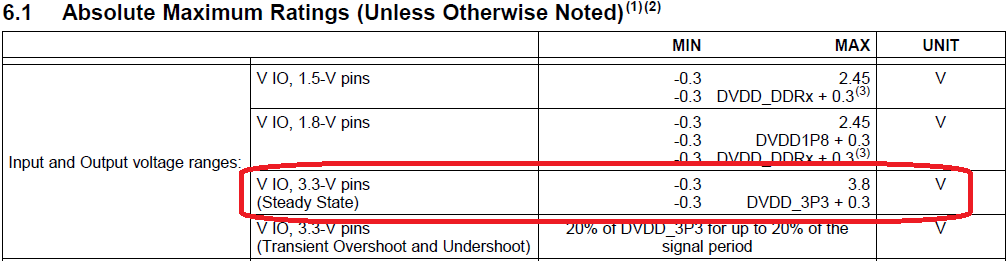

    Can I confirm about "Absolute Maximum Ratings" again?
    There are two requirements:
      a) V IO, 3.3-V pins (Steady State) .. MIN -0.3   MAX 3.8
      b) V IO, 3.3-V pins (Steady State) .. MIN -0.3   MAX DVDD_3P3+0.3
    This Absolute Maximum Ratings is during "Steady State". I think it means during power-on.
    I would like to clarify Absolute Maximum Ratings of during "power-off".
    During power-off:
     - We must satisfy both a) and b) of two requirements?
     Or,
     - We must meet one or the other?
     Or,
     - There are some requirements regarding current value other than a) and b)?
       (from your previous answer)
    Best regards, RY
  • Please check the power supply section of the datasheet. Section 7.1.7 has a very specific note as follows...
    "The device pins are not fail-safe. Device pins should not be externally driven before the
    corresponding supply rail has been powered up. The corresponding supply rail for each pin
    can be found in Section 3.2, Terminal Functions."
    This implies that you should not drive any signals until the power supplies are fully up and stable. Additionally then you also have the absolute maximum conditions which are to be followed at all times, not just once the device is powered up.
    My comment about driving pull up resistors is technically a violation of this, but usually the pull up power supply is also connected to the device power hence typically comes up at the same time as the power supply itself.
    BR,
    Steve
