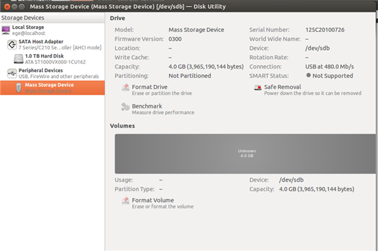

    @argeebee: I opened the disk utility and I choose the mass storage device but unfortunately there is no option with error check.  When I choose my local hard disk, I have the option with check filesystem but for the mass storage device I have no option with this. I am sending the printscreen of my disk utility. When I select format drive, the system faced with error. What should I do to restore the disk? By the way, thank you for your interest.

  • "When I select format drive, the system faced with error."
    Even a fresh blank card out of the box should allow a format.  The capacity of your card can be obtained, so its controller may be working.  Check the lock tab on the SD adaptor and make sure it is not locked.  Also, to make sure the adaptor is ok, try another SD card and see if the disk utility can see it.
    You can only do an error check on a formatted partition.  I suggested an error check after a format to verify that the format could write the card properly.  If you can't recover the card, a new card is relatively cheap.  Another alternative is to boot via NFS, but that can be difficult on the SK's usb/serial port.
