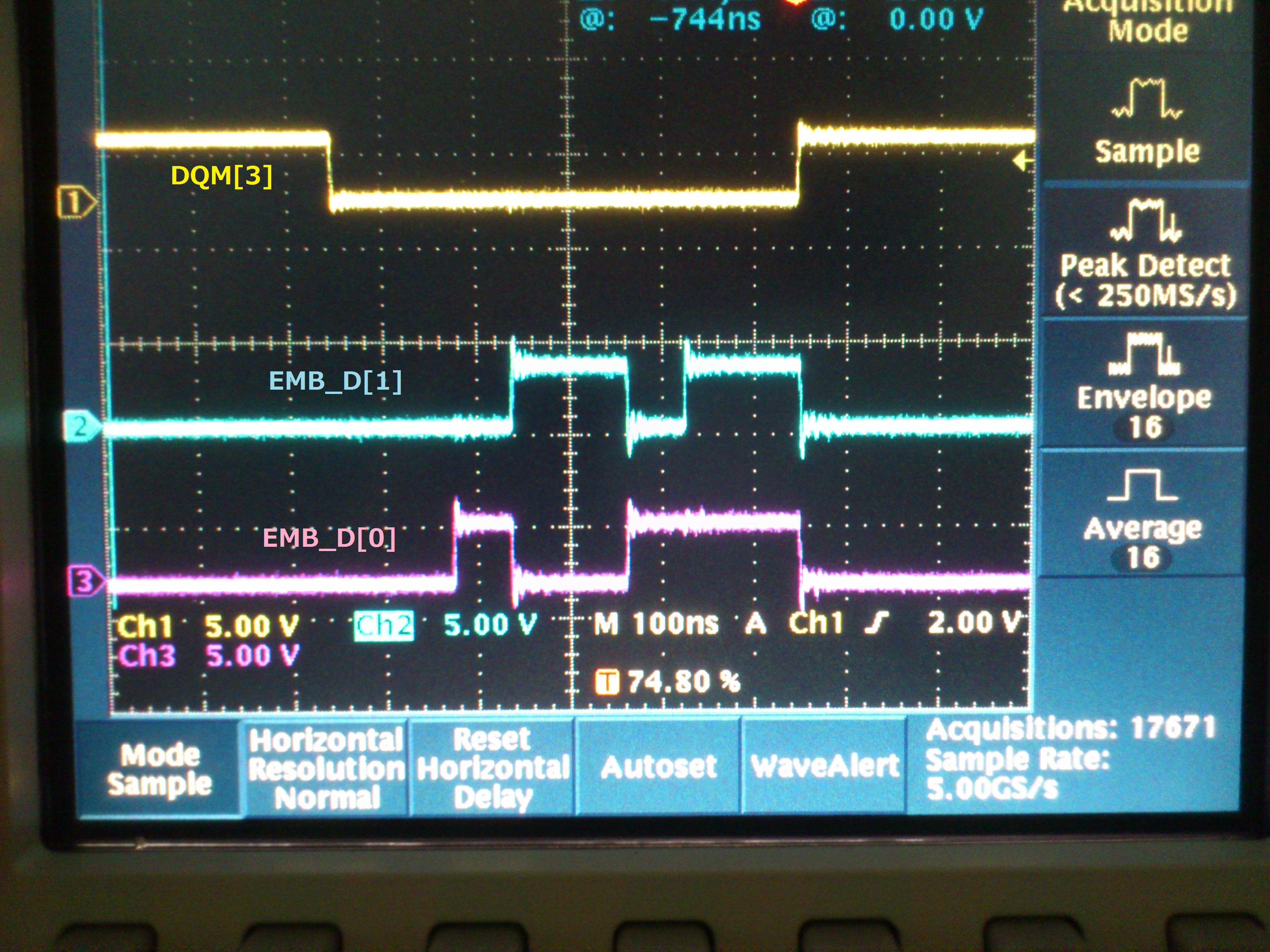

    I did simple read back test with DMA transfer with 16but bus configuration on EMIFB.
    Condition:
      SRC[0] = 0xaaaa5555; (located in 0xC8000000)
      SRC[1]= 0x5555aaaa; (located in 0xC8000004)
      SRC[2]= 0xFFFFFFFF; (located in 0xC8000008)
      SRC[3]= 0x00000000; (located in 0xC800000C)
       DST was located in 0x80000000 (L3 RAM)
    When I execute ACNT = 0x10, I could get below figure::
    Lower 16bit of first word is 0x5555, then D[0] = high, and D[1] = low, and upper 16bit of first word is 0xAAAA, then next cycle,  D[0] = low, and D[1] = high.
    That could lead the the order of C6747 EMIFB 16bit SDRAM read is lower -> upper,I think.
    best regaeds,
    Hirofumi Fujita
  • Hi Fujita-san,
    Thank you for your experiment! This can help to promote that lower 16bit is expected first. To verify it is ALWAYS expected, I need to clarify EMIFB never changes the order of read sequence.
