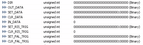

  • Hi Sivaraj, thanks for your wish help.
    I think that gpio is configured correctly . In picture below is shown Gpio regs after manually gpio set. There is no GPDH register in DSP 6455
    To let process to run gpioInternalLoopbackDemo() i commened first loop
    // do {
    gpioEn = (Bool) CSL_FEXT(((CSL_DevRegs*)CSL_DEV_REGS)->PERSTAT0, DEV_PERSTAT0_GPIOSTAT);
    // } while (gpioEn != TRUE);

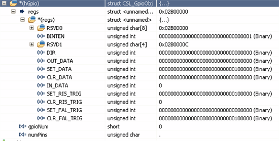

     And in picture below core registers.
  • I had found that GPIO module doesn't included in CCS v5 simulator. It simulates the 64+ core. Megamodule(L1P Progrm Cache, L1D Data Cache, L2 Unified mapped RAM/Cache, L2 ROM), SCR, EDMA3CC, EDMANC(0-3), Timers(2), EMIFA, EMIFB, TCP, VCP, McBSP and external memory. How can I model GPIO interrupt in simulator?
