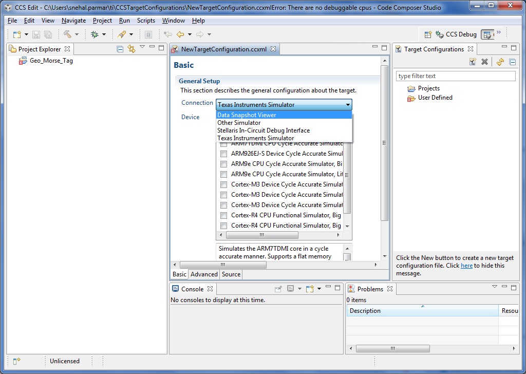

    As we are having getting board up problem we are trying to connect it to CCS for two things : we can reflash the UBL and UBOOT afetr a nand scrub and we can also run the diagnostic utility provided in the package at <rdk_base_installation_directory>/Binaries/dmva2/diagnostic_ipnc_dm368.bin. We need your support for two things :
    1) We are trying to follow the User Guide for the steps to flash the ubl, uboot through CCS but we are not able to get the target connected message (this is in CCSv4.2.3). In CCSv5.0 we are not getting XDS510 emulator option while creating the Target Configuration File.

  • Right now we dont see any messages on the Serail prompt upon startup. At times some messages come .. but they stop with some NAND boot failed message.
    Added image of target config window with CCS 5.0 .. there is no option for XDS510 emulator and no option for DM368 target.

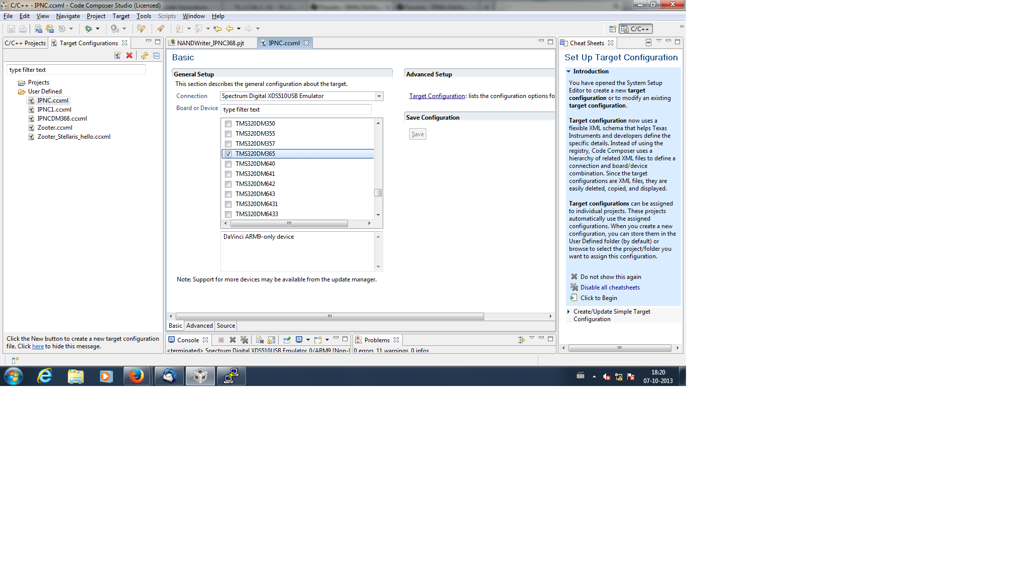

  • Hi Snehal,
     I cannot see the string you entered on the baord or device box.
    What is string you entered? DM368 has 2 options EVMDM368 or TMS320DM368. I see both of them on my PC with CCS 5.2....I suppose you have chosen XDS510USB as the connection???
    Please confirm...

  • Hi Feroz,
    According to what I understand from Snehal he isn't getting the XDS510 USB Emulator option in the connection drop down list at all.We don't know why this would happen.
    Thanks for helping to download the CCSv5.5. Do share the location and credentials once you're done.

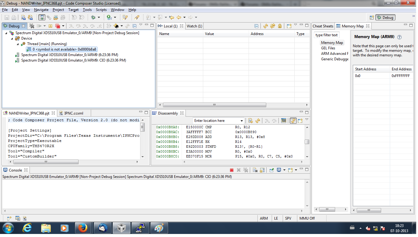

    I have got the connection with the target working with the CCSv4.2.3. I am able to compile the NANDWriter project successfully (provided in the rdk in flash_utils_dm36x). However when I run the NANDWriter project I do not get any prints on the console to enter any file for flashing etc. The program just shows thread running and hangs ...
    Following are the snaps :
    Following shows the gel file :
    Following is the snap which shows that the program is running but i don't get any other activity :
    The  file is as shown :

    Or is it due to not getting some runtime pritf library or something ?

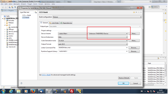

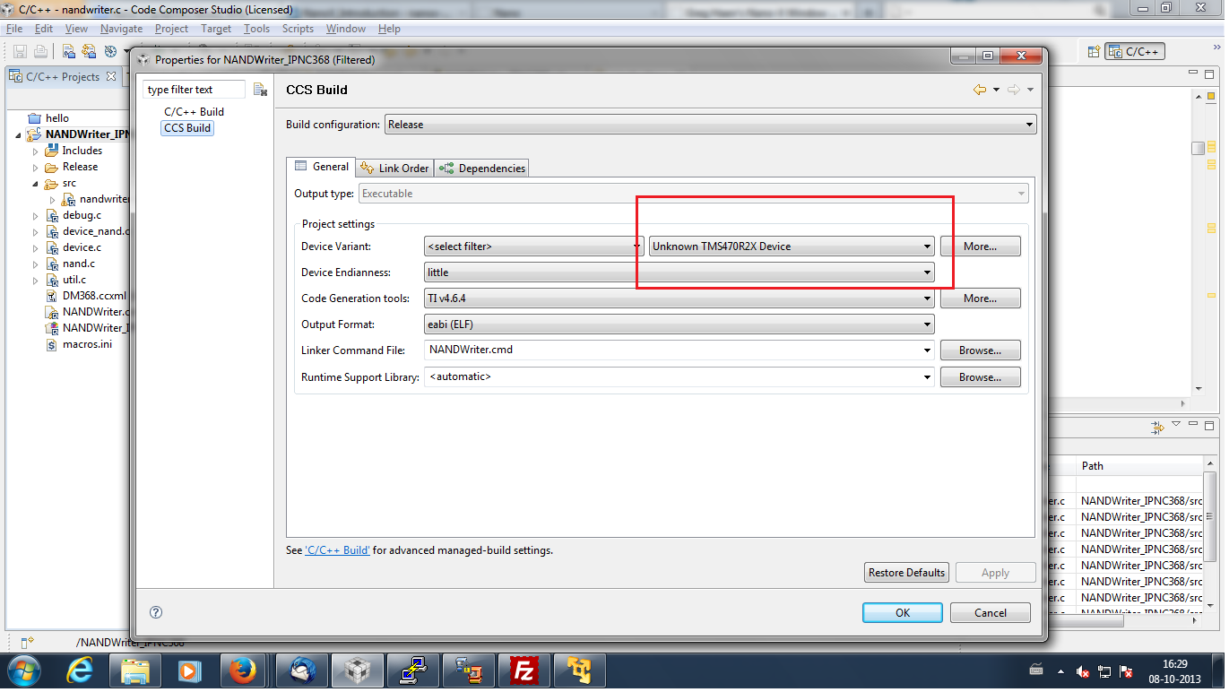

    Thanks for the ftp credentials. While we are downloading the CCSv5.5 I had the following query for my build as mentioned above.
    When we check the NANDWriter_IPNC368's Build Properties we get the following :
    Here as highlighted in the Device variant field it takes unknown TMS470R2X device. There is no option for TMS320DM365/TMS320DM368. I am able to compile the project but when I connect the target I am not getting any prints, not even from then gel file !
    The device is mentioned in the .pjt file as follows :

    Please give some pointers. As I am completely stuck here.
    Charvi.

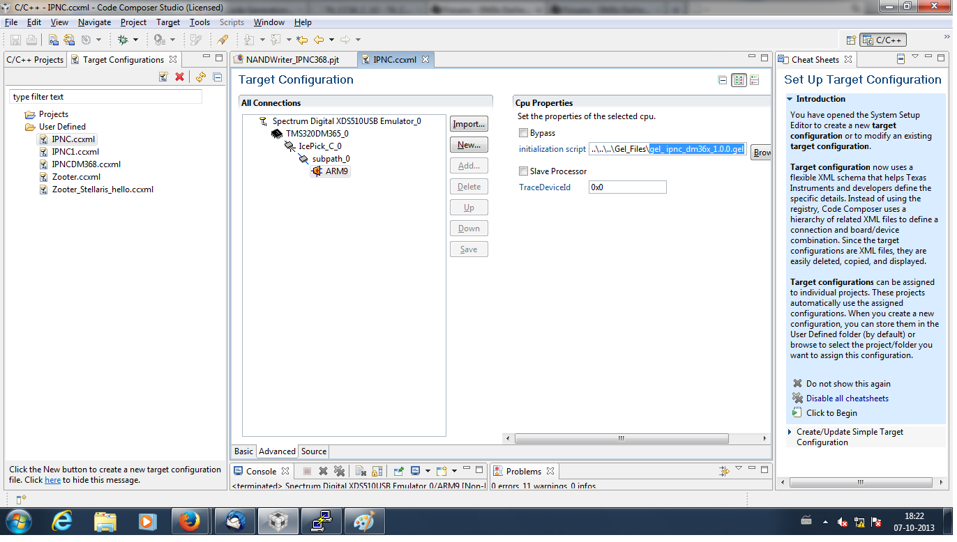

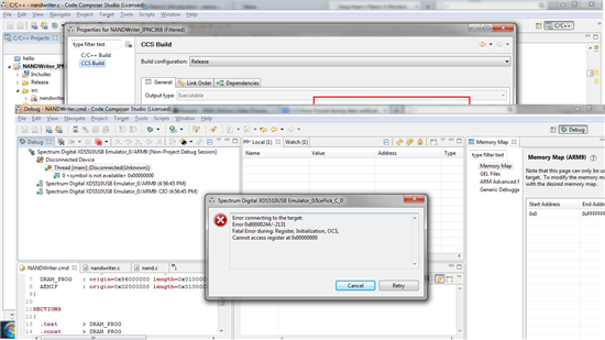

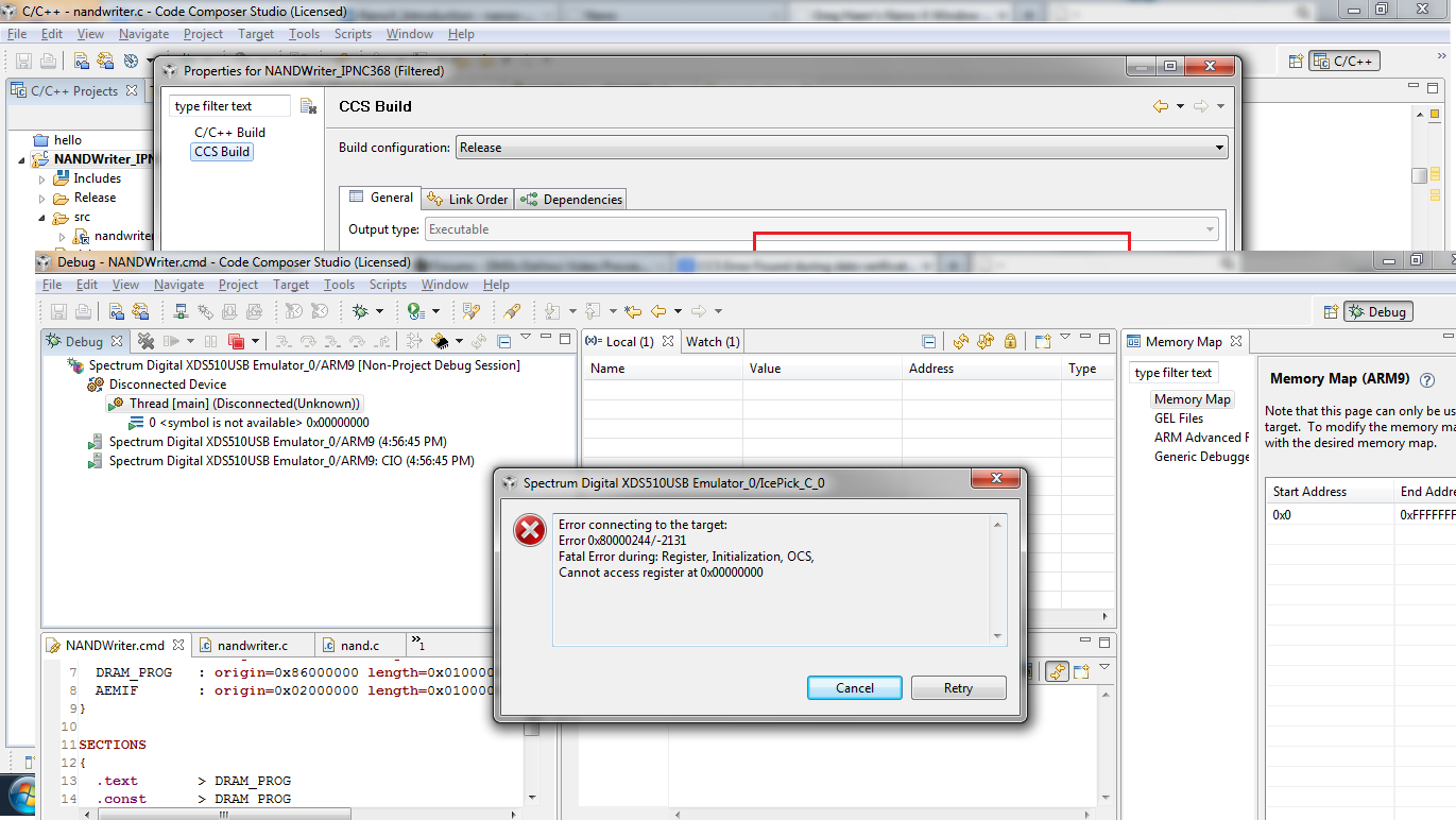

  • Also when I try to load the nandwriter.out via Target -> Load Program after I connect the target I get the following error
    I searched the forum and may be this error comes because my DDR is not initialized. This may be because my gel files isn't executed properly as I don't get any prints from the gel file. I have mentioned the gel file gel_ ipnc_dm36x_1.0.0.gel in the Advanced option in the Target Configuration. Please help.
    Thanks and Regards,
