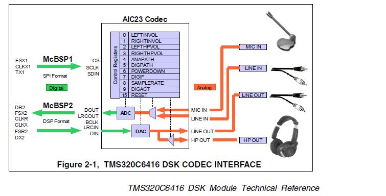

i am using  TMS320c6416 board along with CCS v3.1 to connect two C6416 DSK wirelessly using LEDs. so far, i've got to a point where i can insert voice signal vie the MIC jack and then hear it back vie the headset output jack as . the second stage is to obtain an digital output of the input voice signal and connected to LED.
does the TMS320C6416 DSK provide a digital output?
