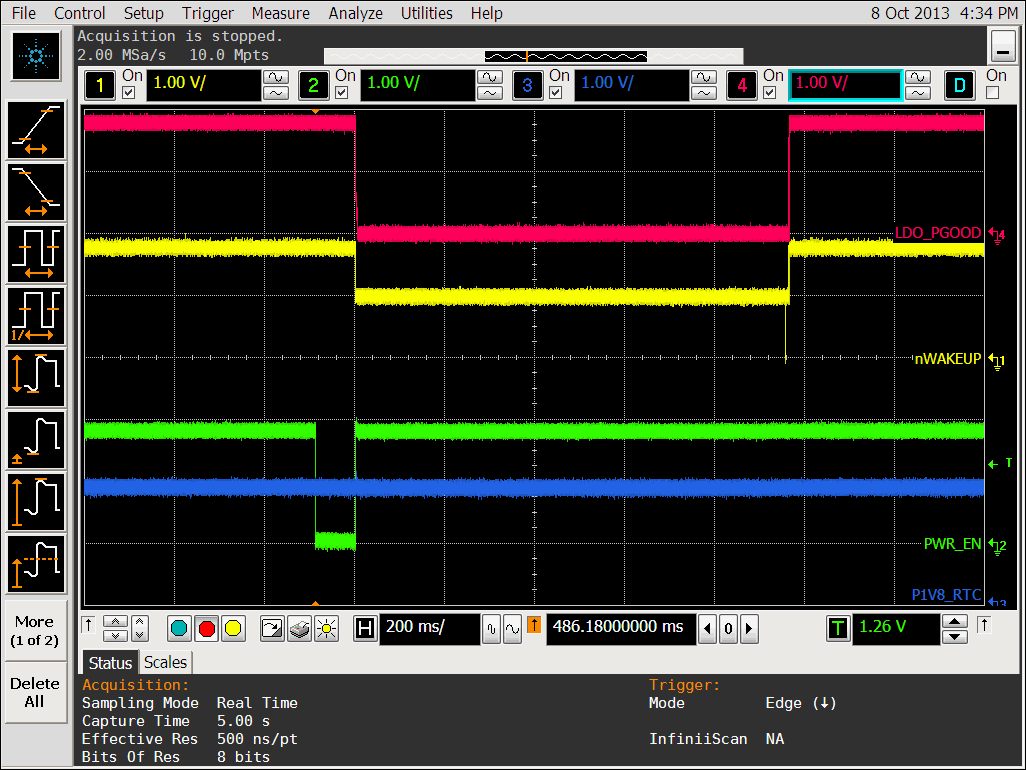

we are using AM3352 processor with TPS65217B PMIC.
We give the 'power_off' command through LINUX kernel and after 2s an ALRM2 event pull-down the PMIC_POWER_EN signal and the SHUT-DOWN sequence is started. Up to here everything is clear.
We note that after the 3V3 domain is SHUT-DOWN, it seems that the AM3352 pulls HIGH the PMIC_POWER_EN pin again: this starts the POWER-UP sequence and the system restarts.
Is this behavior correct? Looking at the datasheet we cannot understand the reason of this behavior.
Anybody can help us?
