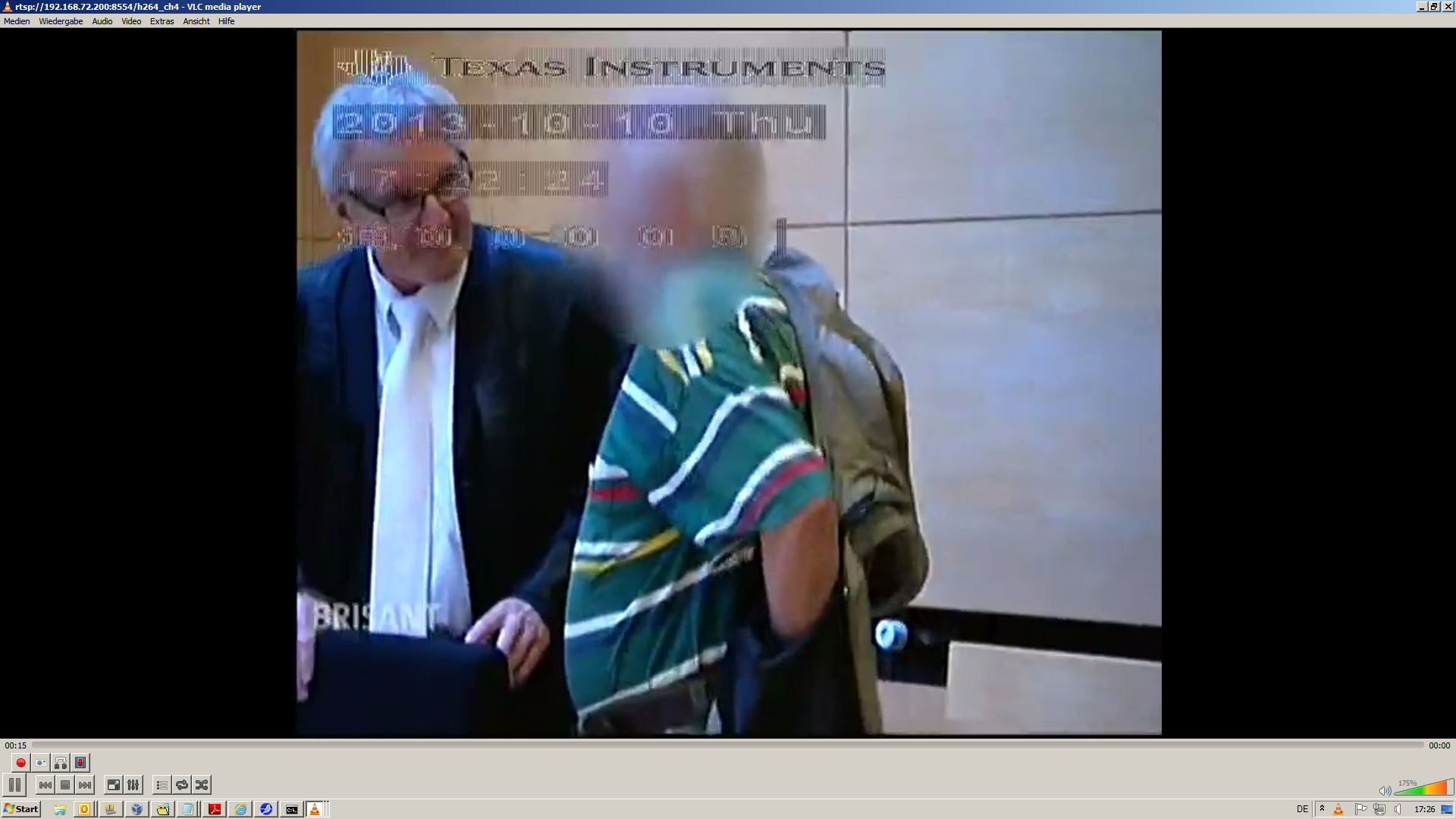

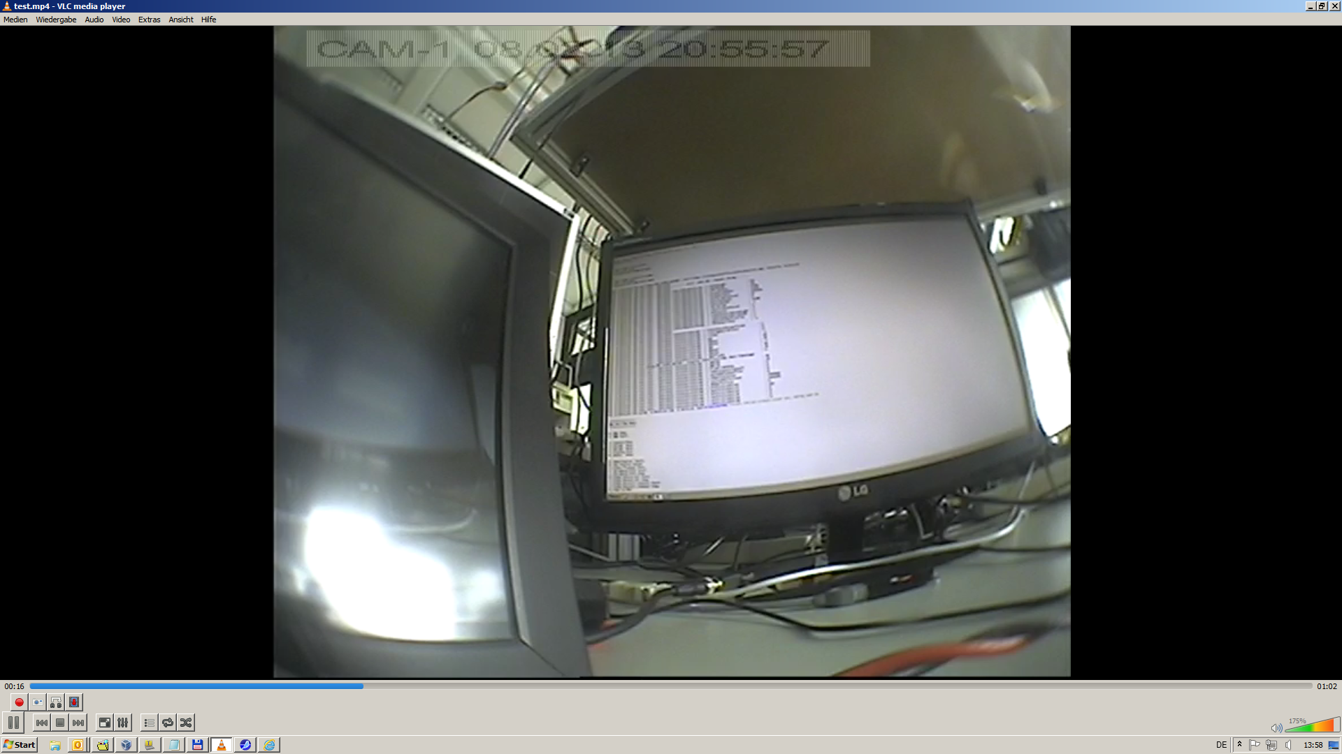

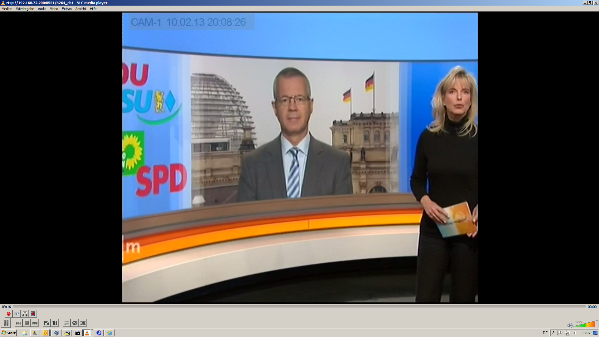

  • Capture side OSD is visible in a recorded file but not in preview window in DVRRDK 04.00.00.03.
    I have attached a snapshot.
