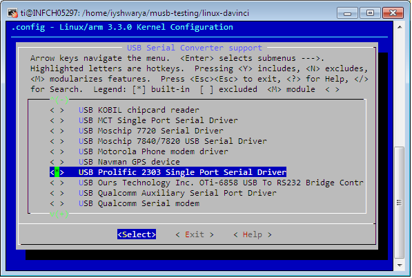

Hello everyone,
I am using the OMAP L137 and trying to connect the USB1 (USB 1.1 port) to a USB-serial converter, in order to connect to a PC. I have enabled the necessary things in the kernel, but I am still unable to find it in the /dev folder. The following is output during boot:
usb 2-1: new full speed USB device using ohci and address 2
usb 2-1: New USB device found, idVendor=067b, idProduct=2303
usb 2-1: New USB device strings: Mfr=1, Product=2, SerialNumber=0
usb 2-1: Product: USB-Serial Controller
usb 2-1: Manufacturer: Prolific Technology Inc.
I guess means I built the kernel properly. But I am still unable to see it in /dev
Please help.
  • Hi Bindu,

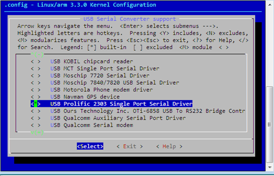

    When the drivers for USBToSerial converters are enabled during kernel configuration, you would be able to see the nodes for the ports like ttyUSB1. I personally experimented ( though it is for OMAPL138 EVM ) and able to get /dev/ttyUSB1.
    Make sure you enabled the following:
    sudo make ARCH=arm CROSS_COMPILE=/opt/arm-2009q1/bin/arm-arago-linux-gnueabi- menuconfig
    Please let me know whether it worksfor you.
    Shankari
    Please click the Verify Answer button on this post if it answers your question.
