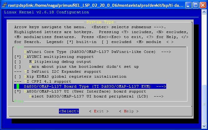

Why i cannot see logo when i boot linux on OMAP-L137 EVM?
Other Parts Discussed in Thread: DA8XX, OMAP-L137
I have add bootup logo of logo configuration.I use NFS file for montavista.
  • Please check whether the following options are enabled in the config
    • Logo option (Standard 224 color) in the Bootup logo section
    • UI card, GLCD, FB options
     If the above options are enabled and still the logo is not appearing, please send the details of software release version and the tool chain that is being used.
  • What's the UI card option in linux config?

  • My guess is that he means Linux Kernel options accessible via menuconfig; although I do not have my software installation readily available to confirm.
    Yes I meant enabling the UI card and other options through menuconfig. Here is the way to enable the UI card option through menuconfig
    System Type --->
       [*] DA830/OMAP-L137 UI (User Interface) board support
            Select DA830/OMAP-L137 UI board peripheral (LCD) --->
            (X) LCD
  • I make menuconfing linux as follow:
    make distclean ARCH=arm CROSS_COMPILE=arm_v5t_le-
    make da830_omapl137_defconfig ARCH=arm CROSS_COMPILE=arm_v5t_le-
    make menuconfig ARCH=arm CROSS_COMPILE=arm_v5t_le-
    I cannot find UI card option on System Type.
    System Type --->
                           ARM system type (TI Davinci)  --->
                   ---    TI DaVinci Implementations
                             Davinci Core Type (DA830/OMAP-L137 DaVinci-like Core) --->
                       [  ] DAVINCI multiplexing support
                       [  ] Multiplexing debug output
                       [  ] Warn about pins the bootloader didn't set up

    The UI option is present under system type. Please see the attached screen snapshot of my menuconfig.
    Also what is the LSP version you are using. We are using the version REL_LSP_02_20_0_06.
    The .config has the following options enabled for UI. Do you see similar options enabled? If not you can paste these lines in .config and try once.
    CONFIG_DA8XX_UI=y
    CONFIG_DA8XX_UI_LCD=y
