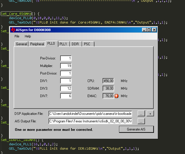

EDIT: AISGen seems to be build for 300 MHz operation (there are couple of places where clock max value could be 50 MHz instead of 76 MHz), because also in PLL0 tab I am unable to use the same settings defined in LCDK gel file for 456 MHz operation.
device_PLL0(0,18,0,0,1,11,5);
device_PLL0(unsigned int CLKMODE, unsigned int PLLM, unsigned int POSTDIV,unsigned int PLLDIV1, unsigned int PLLDIV2, unsigned int PLLDIV3, unsigned int PLLDIV7 )
I cannot put them AISgen, it says that for EMAC it must be number between 1.0 and 50.0:

    Your calculations are correct for the max SPI clock at 300Mhz and 456Mhz but the testing of the AISGen tool only had max coverage of 50Mhz SPI clock which is why it was limited to 50 Mhz. We may be able to increase this but will need further testing before being able to enable this functionality. For the time being using the HexAIS command line utility with the INI file is the best option to enable this usecase.

    50 MHz is the max SPI clock supported for master mode, as per the data sheet, this is true for 1.3V operating point too (456 MHz). Please check Table 5-70 in the datasheet and let me know if you see any confusion.

  • Table 5-70 seems not to be correct one, however Table 5-68 row 1 states that minimum SPI0_CLK cycle time is 20 ns, which is 50 MHz. As I can see it does not depend on DSP clock frequency.

    The table in the datasheet is right. If you are running DSP at higher frequency you will need to get the SPI clock down using SPI internal divider.
    Please see the PLL calculator, it will give more visibility in to the device , CPU, peripheral clocking scheme
    http://processors.wiki.ti.com/index.php/Programming_PLL_Controllers_on_OMAP-L1x8/C674x/AM18xx
