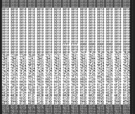

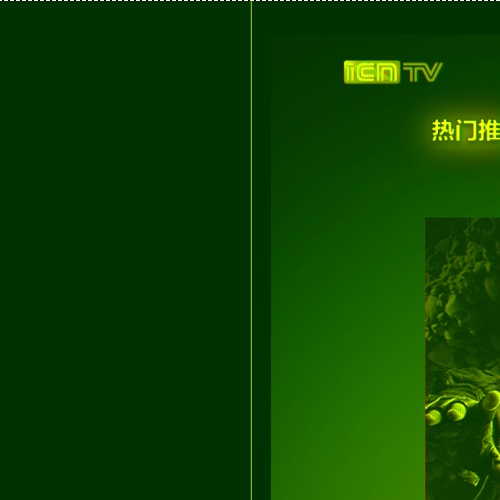

I am currently want to configure the DM8148 VIP Port A to receive a 16 bit YUV422 video stream 720P60 (or 1080P60) with embedded sync  from  a  external decoder (adv7611) .
 Now  , we could  recevie  the  stream ,   but  it  have some problem about  HSYNC,   the  HDMI  LCD display the movie  with  some  H BLANK DATA . 0X8010 0X8010 .......
   and  the  movie displayed  as follow:

MY PROBLEM IS
1.  There  are  a lot  of    H  blank  displayed  ,    i  think  it  should  be  filtered by  capture.   is that  right?
2.   If  we  use   EMBEDDED_SYNC  mode,  it is no use for  disconfig  parameters and  HSYNC ,VSYNC , DE, signals etc  ?
3.   now we use 16bit yuv (bt1120?)  , and we  also tried 8bit  bt656 iinput ,   and i  refer a document,  it said that it can not  exceed  950 pixel per line ?   how  we  receive  720P or  1080P ?
4.  is  there  some others to config to  correct it ?   or the  output of  adv7611 is error ?
