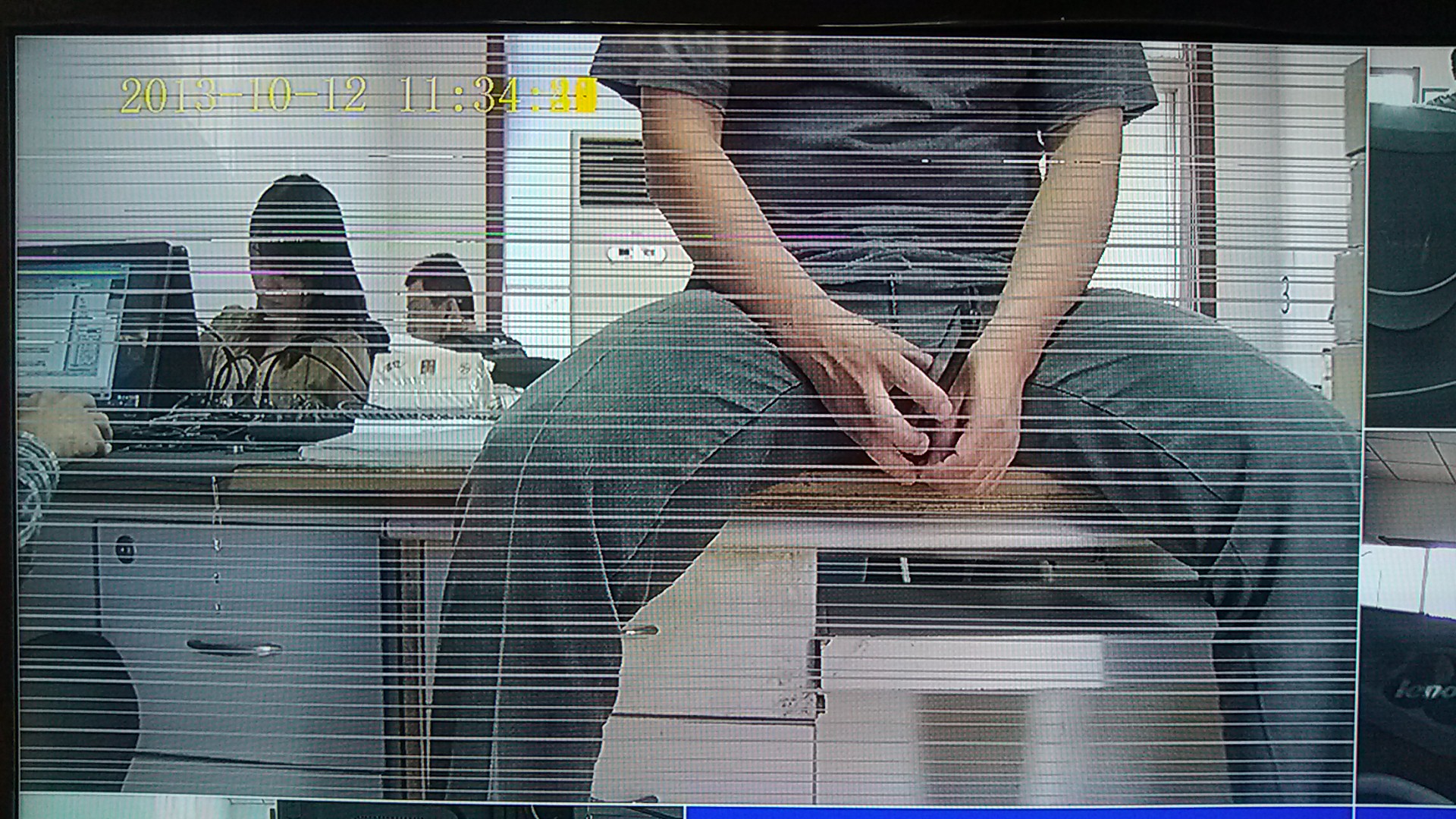

Hi, everybody
I'm using RDK 4.0 , 8168, In my usecase, there are 4 HD-SDI cameras, 1 HDMI display, CaptureLINK,SwmsLINK and DisplayLINK are adopted.

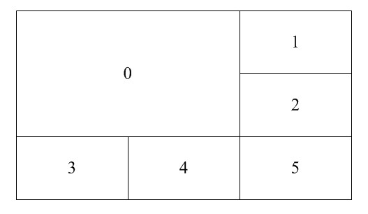

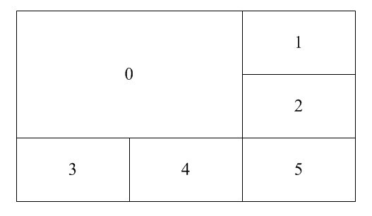

Swms Layout is depicted below
Camera 0(channel 0 in SwmsLINK input queue) mapped to window 3
Camera 1(channel 1 in SwmsLINK input queue) mapped to window 1
Camera 2(channel 2 in SwmsLINK input queue) mapped to window 2
Camera 3(channel 3 in SwmsLINK input queue) mapped to window 0

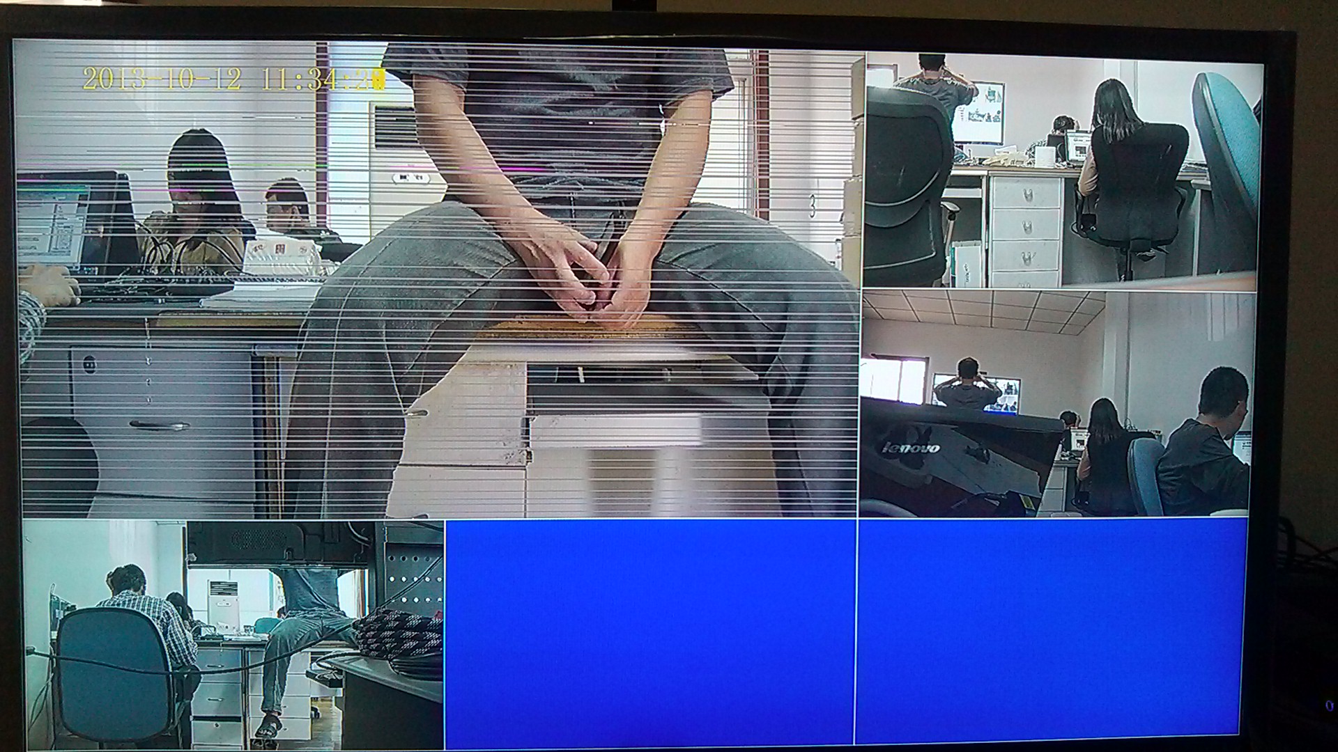

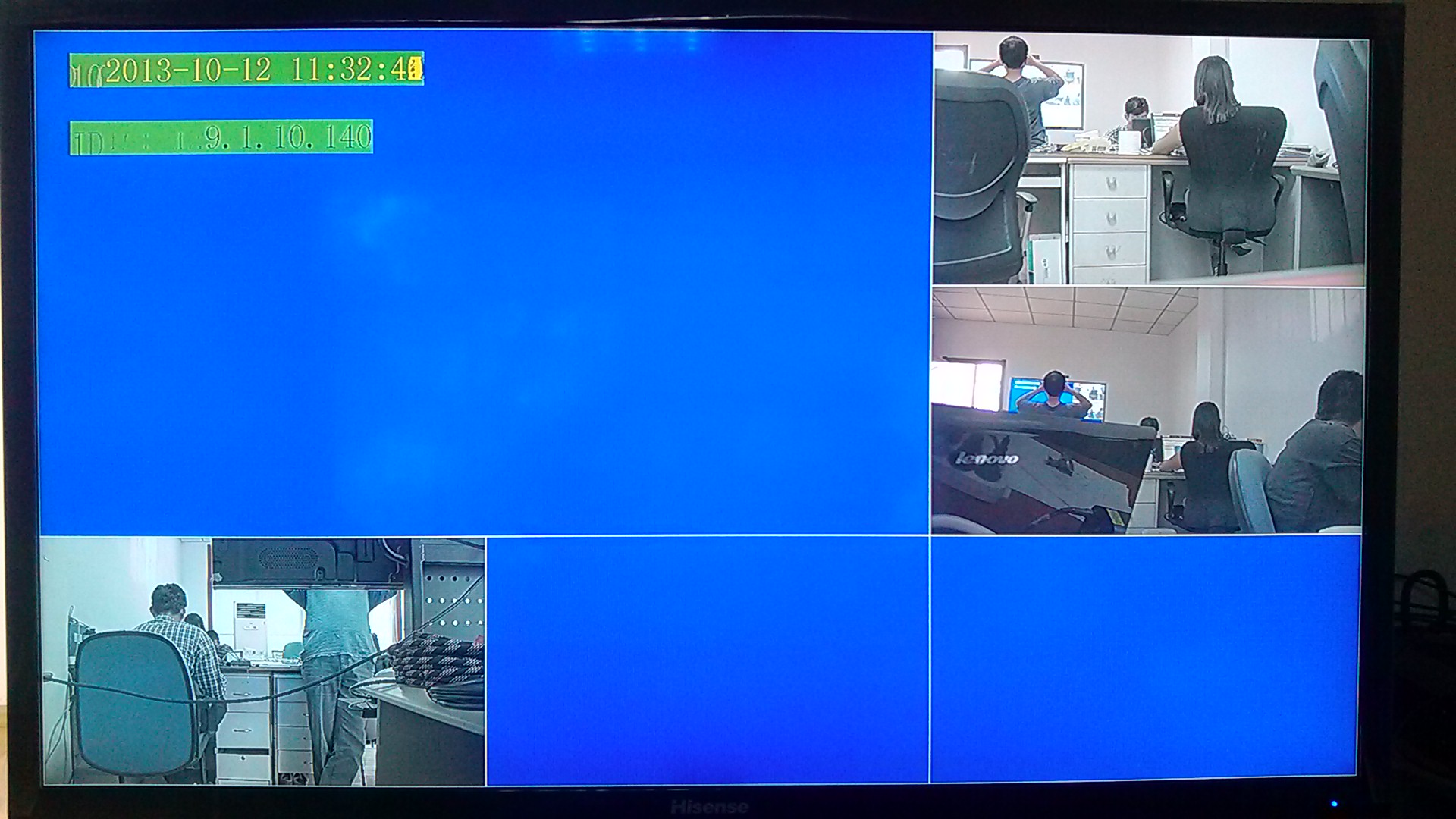

problem:
All images is normal except in window 0;
When powered on, window 0 appears as blank window, which should display camera 3;
After several seconds, general less than 30 seconds,
full screen
window -0
image in window 0 not smooth, be flushed several minutes.
CaptureLINK statistics infomation is shown below:

  • The capture is not receiving any frame for channel 3 initially and later channel 1,2,3 receive invalid width/height frames. If you are sure h.w is not issue it much capture driver configuration .Pls print all parameters in
    CaptureLink_drvCreateInst()
    Vps_CaptCreateParams *pVipCreateArgs ---> In this structure
     between working RDK 3.0 code and not working rdk 4.0 code.
    Also share you captureLink configuration in your usecase file and capturelink create time logs

  • I have solved the problem of image right shifting, but image still flicker. As depicted following,
    My modification steps ( advanced parameters for VIP1_PORTB ):
    1) advancedParams.disSyncLineCaptureStyle must be set to SYSTEM_VIP_LINE_CAPTURE_STYLE_HSYNC or SYSTEM_VIP_LINE_CAPTURE_STYLE_DONT_CARE, otherwise, the window to which VIP1_PORTB be mapped will be blank;
    2) The black stripe will be eliminated when advancedParams.disSyncHsyncPol be set to SYSTEM_VIP_POLARITY_HIGH,
    3) But when I set advancedParams.disSyncActvidPol and disSyncVsyncPol to any valid value, Image flickering can not be fixed anyway.
    How can I fix this issue, Thanks a lot!
