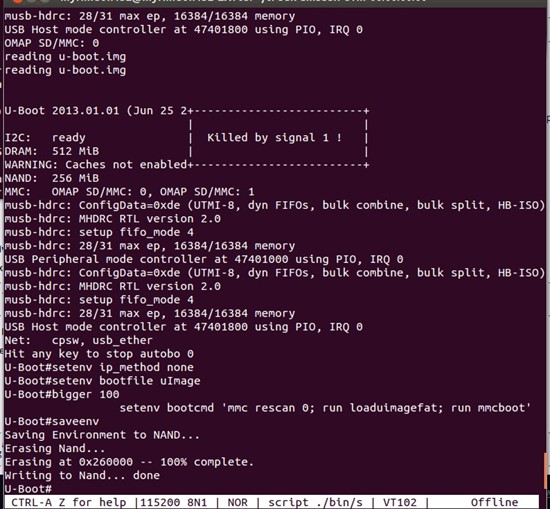

Hi all,
I'm a student trying to set up the AM335x EVM for linux development. I ran the create-sdcard.sh script to use pre-build images and after that i ran the setup.sh script.
I'm trying to boot from SD, all goes well until the final step: when U-boot is writing to NAND it says:
writing to NAND..... done
but then it says "killed by signal 1"  ,   "hanging up".
I ignored this at first and tried to boot from SD but when the kernel boots it just randomly stops after some time, sometimes it goes pretty far in the process of booting the kernel, and sometimes it stops after 1 second. I don't know but could this be because of the "killed by signal 1" when i ran the setup script?
I don't know if these problems are related but when i tried accessing the u-boot prompt when it says " hit any key to stop autoboot" i can stop the autoboot and i see the prompt "#U-boot" but i can't enter anything from the keyboard.
I can't seem to find anything related to my problem on the forum, please correct me if i'm wrong.
any help would be greatly appreciated.

  • here are the logs:
    running the setup.sh script:

    This step will set up the u-boot variables for booting the EVM.
    Becuase the not all AM335x devices have a NAND, the u-boot variables will
    be stored in uEnv.txt on the boot partition. U-boot will read this
    file on boot.
    Autodetected the following ip address of your host, correct it if necessary
    Select Linux kernel location:
     1: TFTP
     2: SD card
    Select root file system location:
     1: NFS
     2: SD card
    Would you like to create a minicom script with the above parameters (y/n)?
    Successfully wrote /home/myrmidon132/ti-sdk-am335x-evm-06.00.00.00/bin/setupBoard.minicom
    Would you like to run the setup script now (y/n)? This requires you to connect
    the RS-232 cable between your host and EVM as well as your ethernet cable as
    described in the Quick Start Guide. Once answering 'y' on the prompt below
    you will have 300 seconds to connect the board and power cycle it
    before the setup times out
    After successfully executing this script, your EVM will be set up. You will be
    able to connect to it by executing 'minicom -w' or if you prefer a windows host
    you can set up Tera Term as explained in the Software Developer's Guide.
    If you connect minicom or Tera Term and power cycle the board Linux will boot.

     Hit any key to stop autoboot: 0
     U-Boot#setenv ip_method none
     U-Boot#setenv bootfile uImage
     U-Boot#bigger 100
     setenv bootcmd 'mmc rescan 0; run loaduimagefat; run mmcboot'
     U-Boot#saveenv
     Saving Environment to NAND...
     Erasing Nand...
     Erasing at 0x260000 -- 100% complete.
     Writing to Nand... done
     U-Boot#[?25l+-------------------------+|                         ||  Killed by signal 1 !   ||                         |+-------------------------+[?25l[?12l[?25hRx, HB-ISO Tx, SoftConn)                              musb-hdrc: MHDRC RTL version 2.0                      musb-hdrc: setup fifo_mode 4                          musb-hdrc: 28/31 max ep, 16384/16384 memory           USB Host mode controller at 47401800 using PIO, IRQ 0 [?25l+---------------+|               ||  Hanging up   ||               |+---------------+[?25l[?12l[?25hRx, HB-ISO Tx, SoftConn)                         musb-hdrc: MHDRC RTL version 2.0                 musb-hdrc: setup fifo_mode 4                     musb-hdrc: 28/31 max ep, 16384/16384 memory      USB Host mode controller at 47401800 using PIO, I[?12l[?25h[?1l>[!p[?3;4l>/home/myrmidon132/ti-sdk-am335x-evm-06.00.00.00
    You can manually run minicom in the future with this setup script using: minicom -S ./bin/setupBoard.minicom
    TISDK setup completed!

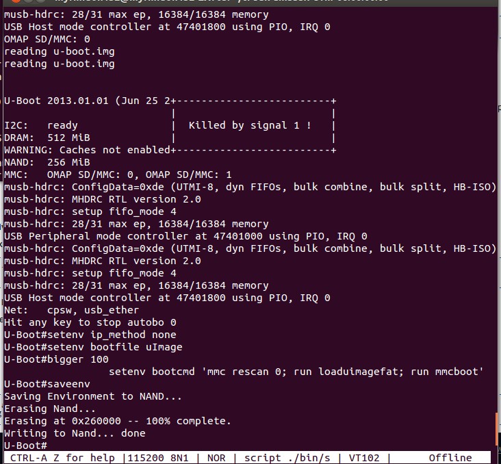

    and here is a printscreen of the "killed by signal 1":

    As i said earlier, here it stops working at "USB Mass Storage support registered." but it just randomly stops around this area.
    Judging by the screenshot, the "Killed by signal 1!" message is overwriting the messages from the serial console meaning that this message is most probably coming from the host system. Also U-Boot doesn't have "signals" to kill processes - it's a kernel thing and the kernel hasn't started yet on the beaglebone, so the message should be coming from the host system kernel. Signal 1 is SIGHUP (hang up), so probably something went wrong with the minicom connection.
    Please, next time the "Killed by signal 1!" message is displayed, exit the minicom and type this on your host PC:
    dmesg | tail -20
    then post the output here - if I'm right it should contain information on what went wrong with the minicom connection.
    You can also try a different terminal emulator (picocom is very easy to use). Just type picocom -b 115200 /dev/ttyS0
    Miroslav
  • This is the output of dmesg | tail -20, i cleared dmesg before running the setup.sh script:
    [ 1778.134511] nfsd: last server has exited, flushing export cache
    [ 1780.462273] NFSD: Using /var/lib/nfs/v4recovery as the NFSv4 state recovery directory
    [ 1780.462291] NFSD: starting 90-second grace period
    Just a reminder, i'm using the EVM and not the beaglebone.
    I tried using picocom but it was the same story.
  • I just downloaded the minicom source code and the popup window showing the error message is generated from Minicom itself:
     * We've got the hangup or term signal.
    static void hangsig(int sig)
      if (stdwin)
        werror(_("Killed by signal %d !\n"), sig);
      if (capfp)
        fclose(capfp);
      keyboard(KUNINSTALL, 0);
      hangup();
      modemreset();
      leave("\n");
    For some reason minicom is receiving a SIGHUP signal and the attached handler (shown above) is executed:
      /* Signal handling */
    signal(SIGHUP, hangsig);
    The handler also stops the keyboard from sending anything to the serial connection, which explains why you are not able to type in anything.
    This signal is issued by the host PC.
    Please try the following without the need for a serial connection:
    1. Connect your SD card to a card reader, run the create-sdcard.sh script located inside <sdk_folder>/bin/ and choose to have only 2 partitions and use the pre-built images included in the SDK.
    2. Plug the SD card into the EVM slot and set the SYSBOOT swithes for SD card boot as shown here. (Please note that the SYSBOOT switches are labeled incorrectly - ON is on the wrong side.)
    3. Power the board and wait for the LCD to show the Linux logo (note that the CPLD switch should be in a state which allows using the LCD - for example Profile 0).
    This is the first time we encounter such an issue so I believe the EVM should boot just fine using the steps above and the problem is somewhere on the host PC, but I could be wrong. Please let me know about your progress so that I may investigate further.
    Miroslav
  • We connected the EVM to another computer, ran the scripts and tried what you suggested but encountered the same issue. We knew the EVM worked when running Android or Windows (we tested that a few weeks ago) but these failed to boot too now so our teachers examined the hardware. It turned out that some of the NAND memory was broken and maybe that's the reason for the signal 1.
    We're going to wait for a new EVM to arrive and we will continue our research.
    I would like to thank you Miroslav for the help and the thorough research you performed, it was very informative.
    You'll continue to hear from us in future posts :).
