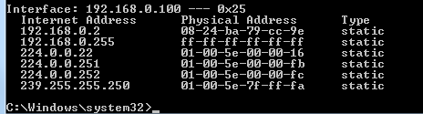

I have tried to build and run the videoTranscode example found in C:\ti\mcsdk_video_2_1_0_8\examples\transcode on the TMDSEVM6670LE board.
I am having trouble with the board not pulling the video file via TFTP.
TFTP server on the PC returns a timeout:
Connection received from 192.168.0.2 on port 32768 [14/10 17:08:29.816]
Read request for file <airshow_p1280x720.264>. Mode octet [14/10 17:08:29.816]
OACK: <blksize=1460,> [14/10 17:08:29.837]
Using local port 58018 [14/10 17:08:29.837]
TIMEOUT waiting for Ack block #0  [14/10 17:10:04.889]
Would appreciate help on where to start debugging, I am fairly new to working with these boards.
Addtional information/files:
  1. tftp.cfg as used by the project: 3632.tftp.cfg
  2. arp table on windows PC:
  3. TFTP initial request ack:
  4. TFTP error:
  5. Wireshark capture file, extract with 7zip: http://e2e.ti.com/cfs-file.ashx/__key/communityserver-discussions-components-files/639/7360.VideoCodecTestErrorC6670.7z
Thank you, look forward to solving this problem.
