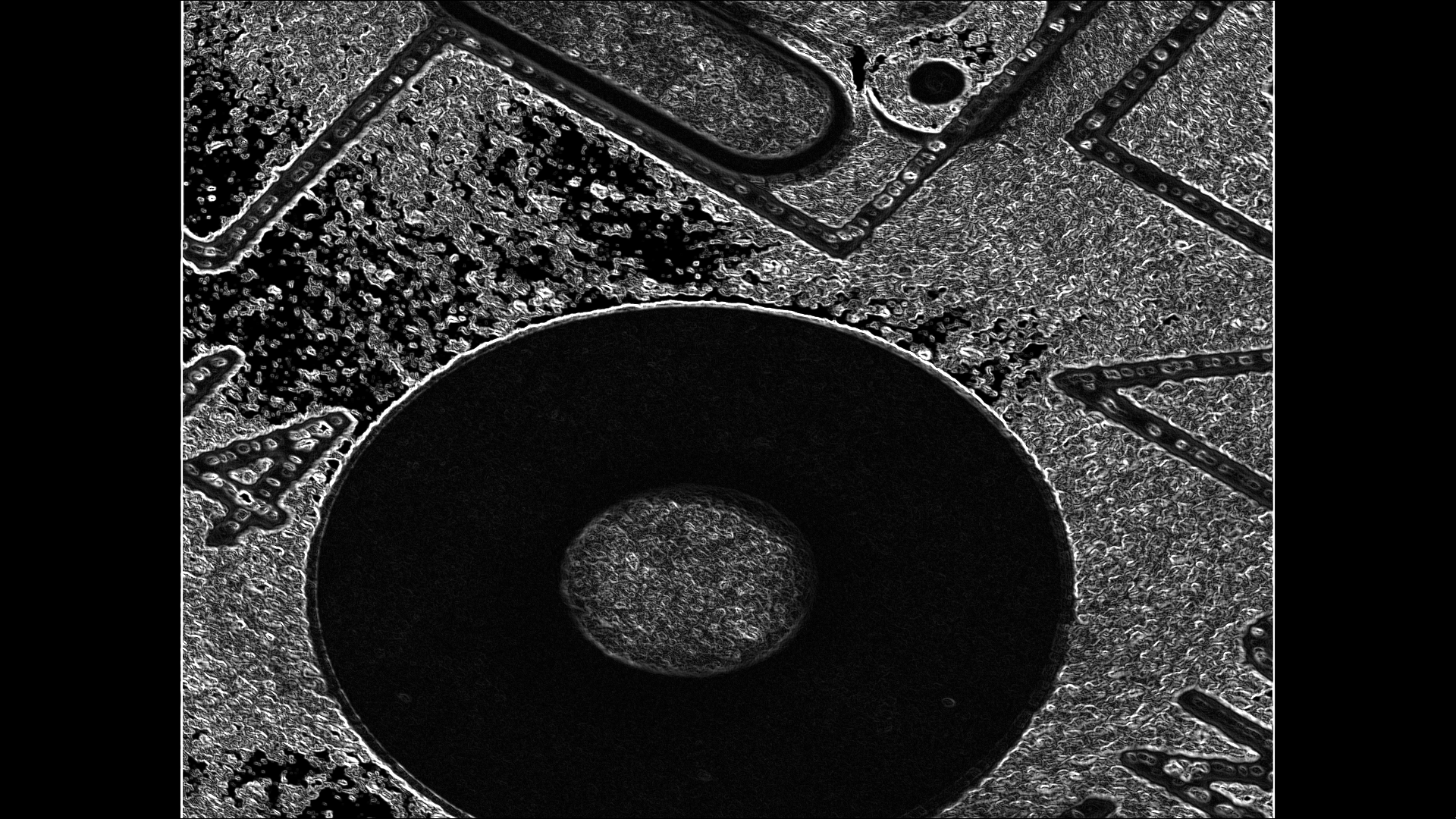

I try to do some image processing using c6678. And I get a correct result (as the 1920x1080 resolution image) using only one core.
Then I try to use 8 cores to do the same image processing, but I get the result with some defects as the marked place in the following image.
I think it could be the coherency problem. So I search the forum and then use Cache_inv / Cache_wb to make sure the coherence. But I still can not solve the probelm. My steps are as follow:
1. Write the image raw data to DDR, named pucInData.
2. For each core,
    Cache_inv(pucInData, nImgHeight*nImgWidth, Cache_Type_ALL, TRUE);  //Invalidate image data to make sure I see the right data in each core.
    //do the image processing
   Sobel(pucInDataPtr, pucDataOutPtr, nImgWidth, nProcessLength);    //pucInDataPtr = pucInData + an offset to the proper start position.
    Cache_wb(pucDataOutPtr, nProcessLength, Cache_Type_ALL, TRUE);  //write the data back to make sure I can get the right data in Core 0.
3. In Core 0, after each core complete the operation,
    Cache_inv(pucDataOut, nImgWidth*nImgHeight, Cache_Type_ALL, TRUE);  //Invalidate the data to make sure I can see the right data.
pucDataOutPtr is the address of the processing result in each core which I aligned to 16 byte (128 bit).
I print out some information:

Then I guess, the data align could be 128 byte. So I aligned the pucDataOutPtr in each core to 128 byte. But the result is still the same.
So, where is my mistake? How can I fixe it? Thanks.

  • Hi all,
    Thanks for your help. I find out where the problem is.
    I use the soble function from ImgLib and do some modification. But the problem is not on what I modified. The problem is the output buffer is 128 bit aligned, but the sobel function fill the output buffer from index 1 not from 0.
                       Core        A          B         C        D         E          F         G        H
                                   0       128      256    384    512    640     768     896    1024
    The output buffer |--------|--------|--------|--------|--------|--------|--------|--------|
    Sobel index            |--------|--------|--------|--------|--------|--------|--------|--------|
                                     1       129    257     385    513     641     769     897    1025
    There is one pixel overlap (marked in blue background color) between two successive cores. And this is the cause of the error. After I modify the sobel function fill output from index 0, the problem is solved.
