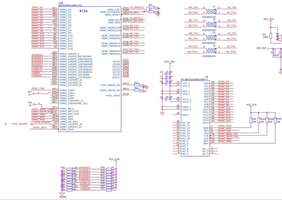

Hi all,
     I am using DVRRDK V4.0 on my own 8168 board, and the NAND is MS320DM8168BCYG2 (the same as used in rdk4.0), after the board can be booted by SDCard, here comes the problem:
     it's OK to r/w NAND(or even boot from NAND) in uboot, but FAIL to read NAND ID(should be "0x2c, 0xca", but it read out "0xff, 0xff" actually) during or after booting kernel
     So I dump register related with NAND(e.g: GPMC, PINMUX) to try to find out anything changed by the kernel, and it turn out to be nothing
     Can you please advise why would that happen?  And how do I fix it??
     Urgent!  Appreciate for any advise.
ps: the logs:

  • is there anyone can help?
  • How are you building your kernel for your own board? Do you have any custom board specific file introduced in kernel like board-ti8168dvr.c is there for 8168 UD DVR. If yes, pls attach that file for review. What is the buswidth you are passing to board_nand_init()?
  • hi, thx so much 4 replying...
    i'm passing NAND_OMAP_BUS_16 to borad_nand_init()

  • BTW, it's the 2nd time that we made our product based on 8168,
    and it turned out that the u-boot.bin & uImage works fine with NAND on the 1st product which has the same NAND flash & similar SCH to the 2nd product
